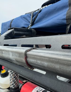

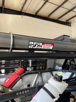

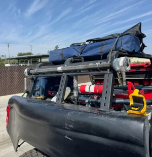

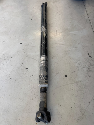

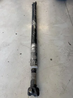

I hope I don’t have to use it, but I’m pretty stoked about this spare idea my driveline guy whipped up. It’s a telescoping ag implement driveline converted to 1350 ends. It can be cut to accommodate any length, so it can be used front or rear on any of the rigs going on our trip. Probably wouldn’t be great on the freeway, but should get us off the trail.
