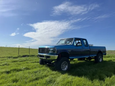

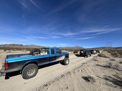

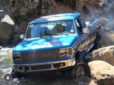

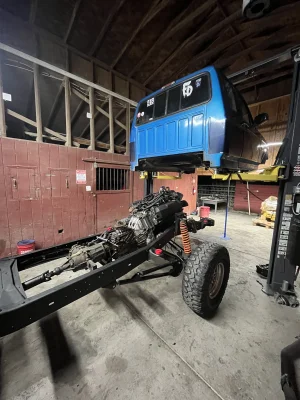

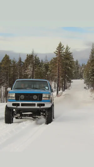

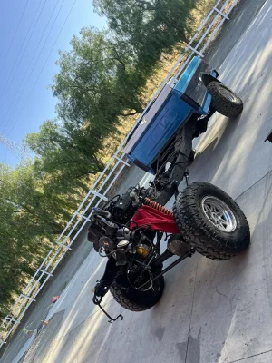

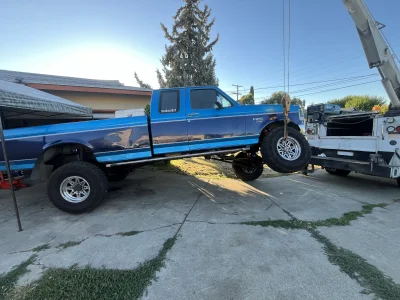

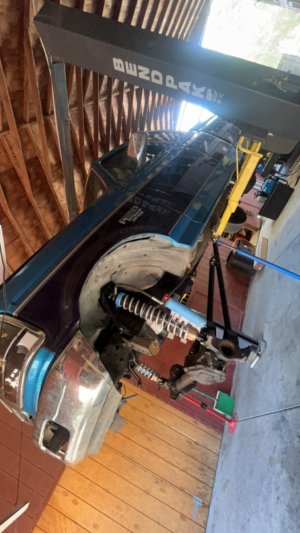

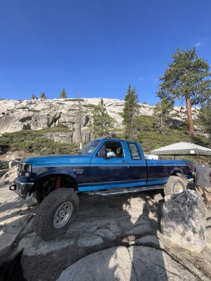

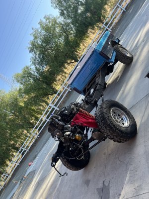

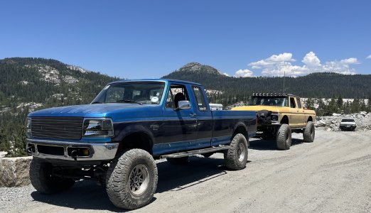

What originally started as a 2wd auto tow rig snowballed heavily into a pretty capable Swiss Army knife of a truck
4 years into the build it’s got
ARP studs with a set of new heads
Top to bottom reseal
Full Force 180/30 injectors
Super duty 17 degree HPOP
CNC fab HPOP lines
KC stage 2 drop in turbo
Power Hungry Performance hydra tuner with full force tunes
Super Duty full aluminum intercooler and pipes
Custom intake and CCV
3 inch downpipe and custom exhaust
Zf5-s42 swapped
Full metal clutch hydraulics
BW 4407 t case swap
04 Chevy 14 bolt rear axle (disc brakes and LSD)
3.73 ratio for cruising speed
05 ford Dana 60 in front (open for now)
Ruffstuff 05 ford radius arm kit
Ruffstuff trac bar kit
Rockhound Offroad shock towers (front)
Ruffstuff shock towers (rear)
Bronco graveyard shackle flip
Ruffstuff heavy duty chackles
Hybrid (bastard) lead pack
Locked Offroad 2.5x10 coilovers (front)
Locked Offroad 2.5x14 smooth bodies (rear)
Rear mounted Warn m8000 winch
PRP drivers seat
Vision wheels beadlocks
37x12.50x17 milestar Patagonia
Assorted led lighting pods and bars

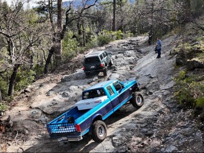

So far this truck has absolutely killed it and done anything I ask of it, from chasing for team 518 at hammers to hauling new projects home and through the rubicon
Future plans are to add hydro assist, a better rear locker and rehear to probably 4.30 or so, it could use a lower crawl ratio. And ruffstuff/offroad anonymous hi steer setup
