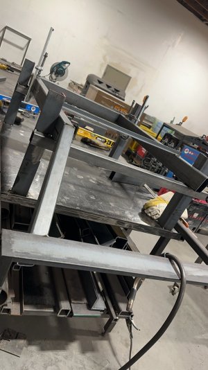

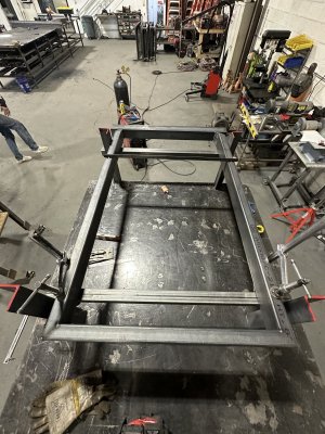

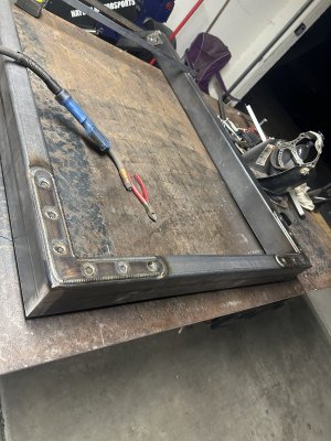

Shock mounts are finally finished. Was kinda a bitch to do so I had it on the back burner lol no where near as nice as most of you guys but I tired haha cnc table will be here in a few weeks and I’m sure I’ll want to redo a lot of the handmade shit I did😂

I did these shock mounts and they were quite the pain in the butt, even with a plasma table!
those came out sick I peeped them on your Instagram haha this was one of those learn as you go kinda things (the whole truck kinda has been) and I’ve learned so much, but as I’ve learned I’ve learned better cleaner ways to do things, witch is obvious I feel like everyone goes threw that with their first few trucks haha I see how you guys plan and execute shit to a T and am working towards that currently haha

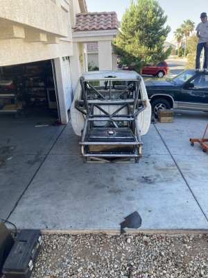

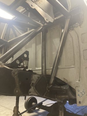

Ran the last 4 structural tubes tonight, the diagonal tube lands on the pontoon tube/frame rail and runs up to the tube that exits the cab off the C pillar. Tube literally touches the cab so I welded the tube to the cab plates about 4” welds on each side as well. The straight vertical tube ties off the bottom of a junction down to the top of the frame where I already had plated because of my pie cut for the frame kick.

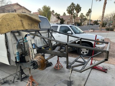

Super small update, ran this secondary a pillar one, because I love the look, and two I just want this thing to be as safe as possible if we where to take a hard tumble. Hopefully I can get some more work done to her here soon!

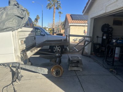

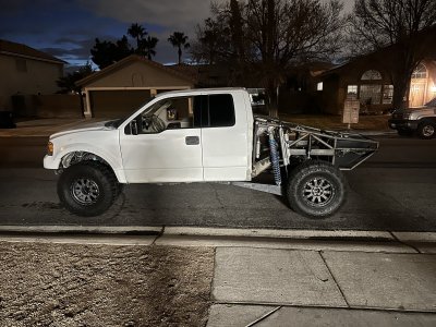

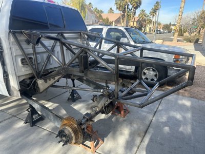

So the ranger got sold a little over a year ago and I purchased a f150 that had a giant motor sports daily driver 3 link that I wasn’t a huge fan of, so I recently chopped off the backhalf of the truck and started adding my own twist to it

Was able to test drive it with the new backhalf for the first time the other day, everything seems to be working out, almost time to flip it around and start installing the blitzkreig lt kit up front

I should add the new frame has 5” of kick, so the top of the oem frame is now the bottom of the new frame, makes 16” of up travel from ride height out of 25 overall inches. I’m gonna assume the front ends only gonna make 17ish inches which is kinda expected from a bolt on long travel kit. Only running 2.5” shocks because I’m not a baller just trying to get back in the desert and have some fun

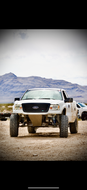

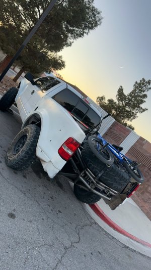

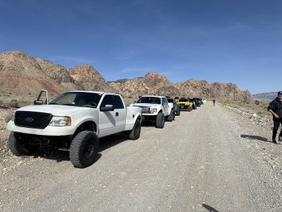

Finally wrapped up the truck for now, took it out to the mint 400 last week and did 40 off road miles all the way to prim and it did awesome, super small kinks to work out. I’m gonna cage it here soon but kinda dreading it😂
Some photos a from the mint 400 trail run/another random weekend run we did a week or so ago. Absolutely loving this thing so good to be back out in the desert!!
