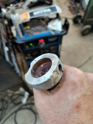

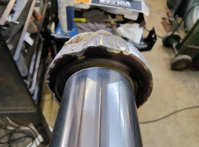

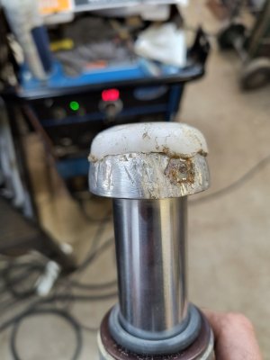

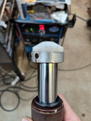

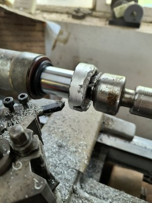

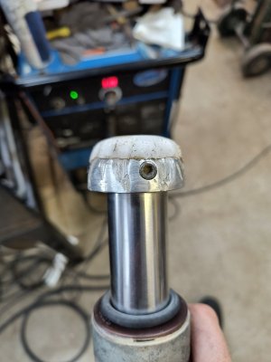

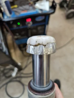

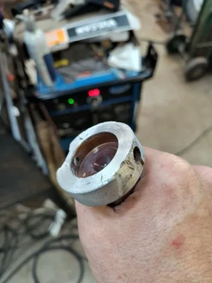

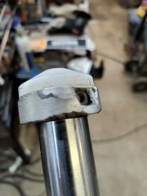

You got to make lemonade. Truck had a bad set up for the bump stops and were getting hit by the bolts for the spring perches. After the last trip it destroyed the pad that was brand new. Decided to weld them up and turn them back to size. With the new set up Ill get the last bit of up travel it was missing and centered the bump stops so they'll clear the bolts now.

How do you keep the the shafts from spinning in the can?
Lol 515fab I was waiting for someone to ask that, after letting it cool down I put 120psi then a small piece of brass shim in the fox original centering mark and squeeze it with my live center. Light passes were key also the most I could take was .010 so they took little bit of time. I had to build them up quite a bit.
