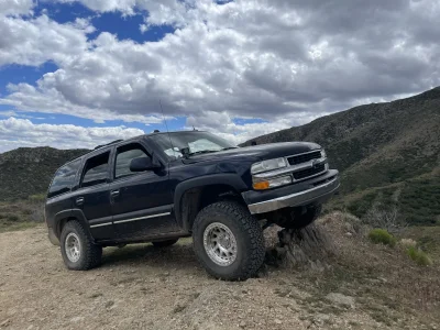

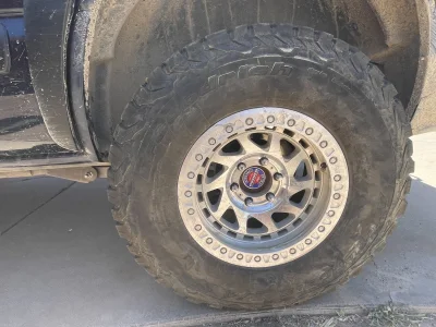

IMG_9811.jpegWas sad with the Patagonia MTs , put some 34ā€ BFGs on it, did the Backway to Crown King and tried the Jeepy tire on a rock thing…

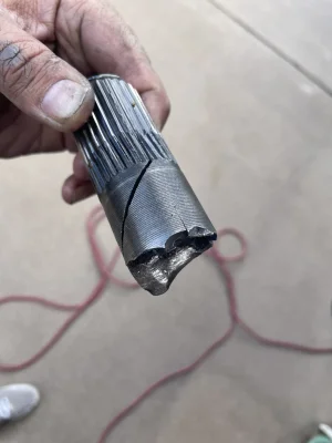

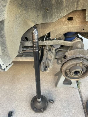

I broke a rear axle shaft šŸ¤¦ā€ā™‚ļø
I ain’t ever gonna stop breaking this Tahoe!!!
and believe it or not … šŸ™„ nobody makes chromo axles for a 10 bolt 🤣
Ordered some Moser 1541H axles today
If I remember right, Kartek has cut to length axles but idk what spline or diameter you need
I guess that’s about as good as it gets for 8.6ā€ 10bolts

Got the chunk out, had to disassemble the locker to get it out šŸ¤¦ā€ā™‚ļø
Axles in, test drove , good to go šŸ‘
How hard did you load that thing to break it? I was hoping they would hold up in our tahoes for longer. We did gears and carrier upgrade hoping they would last but you have me worried
Tire was up against a rock at a narrow section, Blipped the throttle to get around or over the rock and it popped. Has a Detroit locker and 327k miles, axle shaft had enough I guess.
Those Moser shafts are about the best replacement option I found. They don’t make a chromo axle for these 10bolts.
Best I can figure is see how this holds up with these axle shafts. my goal is leave the basic stock suspension links the same. next step for me is to see if I can get an H2 axle to work since they share the same suspension links and parts as the SUVs. It’s a semi floating 14 bolt would definitely be an upgrade.
