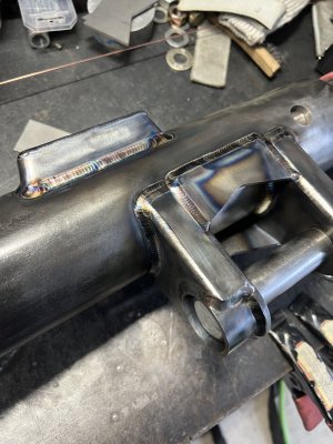

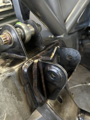

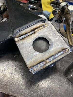

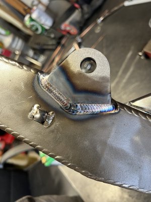

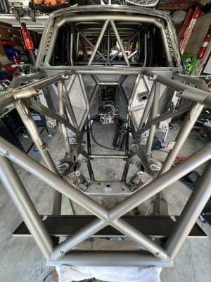

Does doing this many tacks in close proximity help keeping warping to a minimum? Or is there a different purpose?

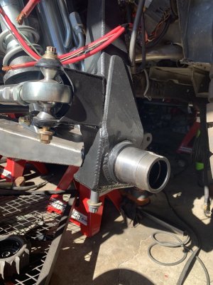

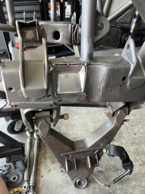

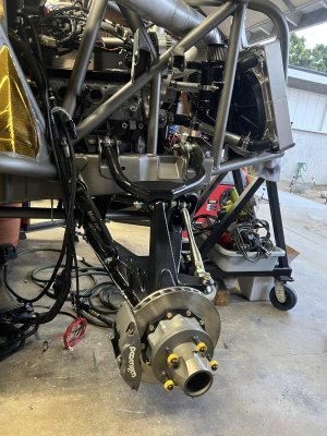

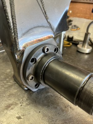

Yeah man, these uprights had the old GN 2.5 snouts with speedway hubs. Hubs were stress cracked to shit and I don’t really care for that bearing spread on something this big/heavy so off they went.Amazing work man, I wondered if what you did to the spindles was possible, but I was thinking about taking the spindles with the factory snouts in them and putting a similar mounting block on to put on a bolt on snout/bigger hub.

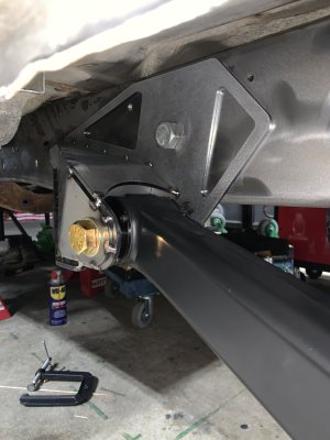

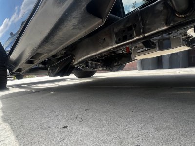

Jason heard and myselfWhos rear lower link frame pivots did you use or did you design them?

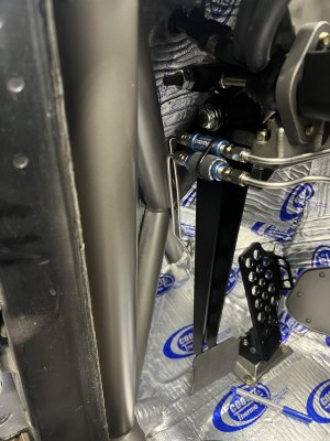

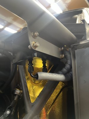

2# to start, might try 4# after a bit to see if it’s better without too much dragWhat size residual valve are you running for the brake lines? I'm debating what ones to run on mine.
