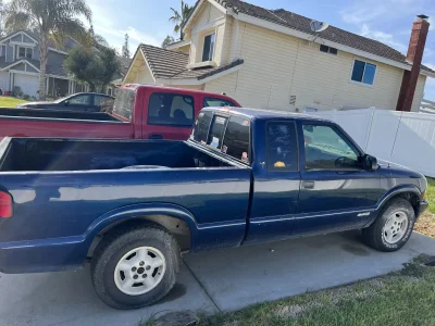

All right it’s time to start a thread for my 2001 Chevy s10 with all my pans and goal
Current plan for this truck is long travel links cage back half v8 you know the good stuff

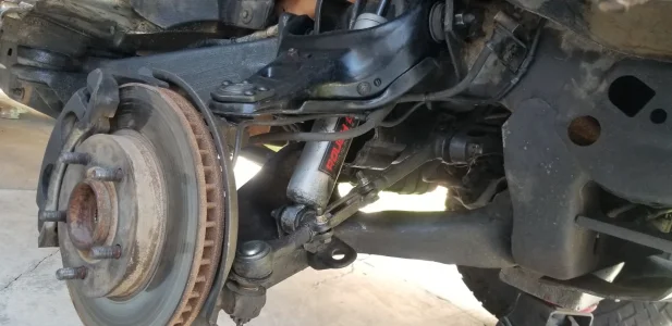

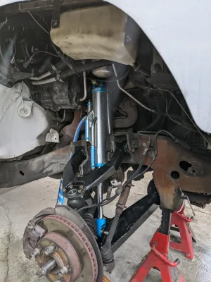

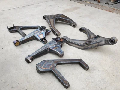

Currently for the truck I have a custom j arm kit that’s made by my buddy Daniel (Danielson.92 on insta Check him out he’s got cool stuff)
The kit is 4.5” wide and pushed the arm 3” forward for better tire clearance

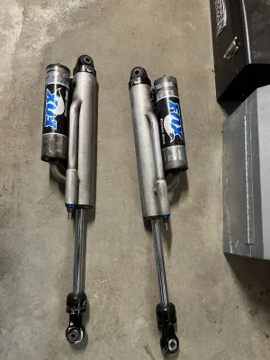

Fox 2.5x10” coilover
Fox 2.5x10” 2 tube bypass

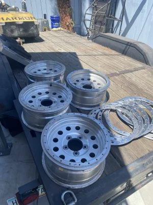

Willwood super lights
6 old school ultra bead locks

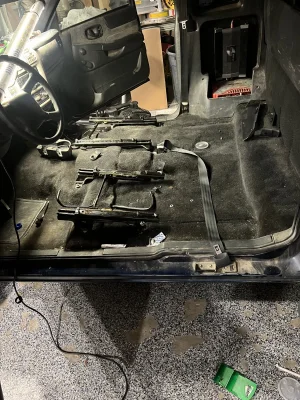

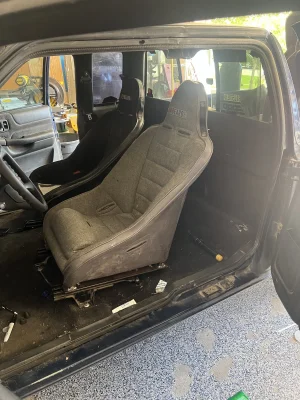

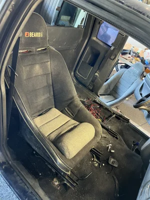

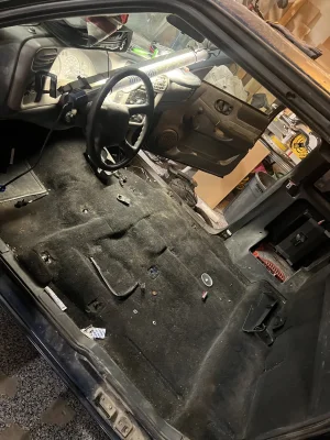

Got bored this weekend and mounted some buckets seats thet I have had laying around for it.

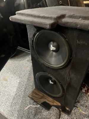

Since this is kinda of a temporary thing I just make some adapter brackets do it will just mount to the stock sear sliders along with that I took out the 2 15” subs the truck has since they would never fit in the truck later on
Also if anyone has an extra butt pad laying around for some beard seats I need one

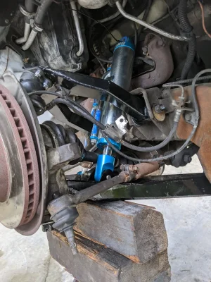

With moving the front end 3" forward, what's your plan for steering?
I believe we’re going to have to just remake the drag link to make it work with the steering box nothing too crazy
I think moving the steering box may be in your future. When I was building OBS Chevys all day long with 1" forward lower uniballs, I would lose a good amount of steering angle with the box in the stock location.
Stock 4xs10 the balljoint mounts off the rear of the drag link. On these kits I build the new tie rod mounts on the front of the drag link moving the steering forward
I'd 100% move the box forward. It's really not that hard and will make things so much easier.
That's entirely unnecessary on my mid travel kit that's 2"wider 3 forward the steering worked perfect in stock location and extended stock tie rods. On the LT kit I made for chance the only reason the steering needs to move forward is to clear the coilover. And as I just stated all that has to be done is move the pivot to in front of the drag link instead of behind

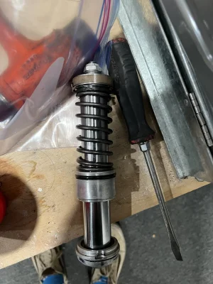

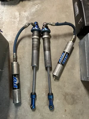

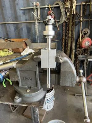

Small update finally got the time to breakdown the coilovers and bump stops . The shafts of the bumps had pitting and corrosion on them so I’m going to send those out to be rechromed and the coilover shafts I was a dumbass and scratch one and fucked the rod end threads when I was change to a shorter rod end on the other so I’ll be getting those cleaned up as well. The shim stack didn’t look too aggressive on ethier so for the mean time the valving will stay the same

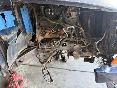

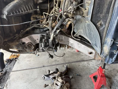

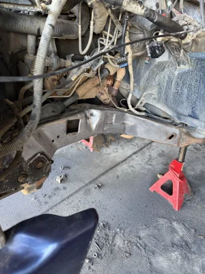

Hover craft mode has finally been achieved.I was finally able to bring the truck to @badvada and get things moving today was just stripping and peeping the frame and I can’t wait for what is too come
