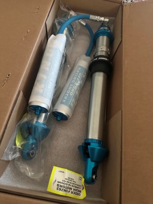

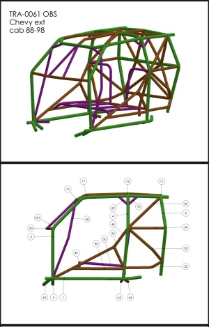

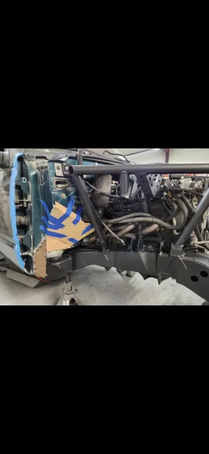

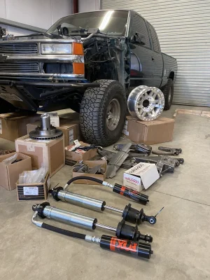

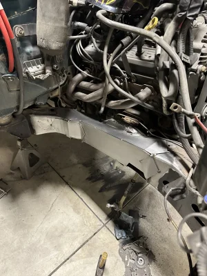

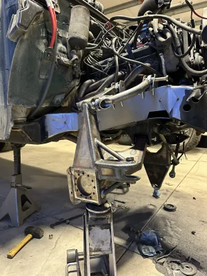

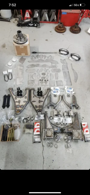

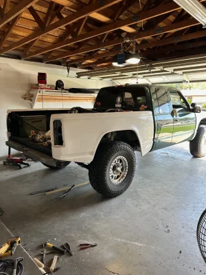

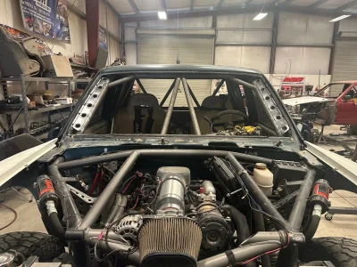

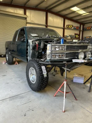

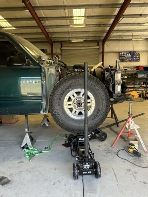

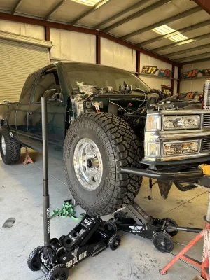

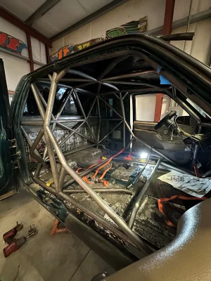

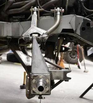

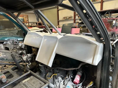

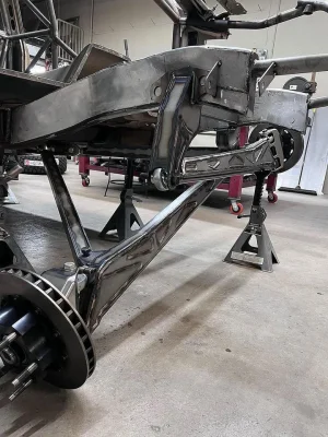

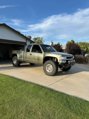

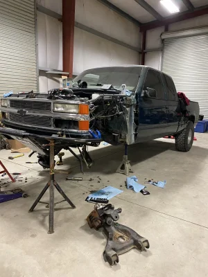

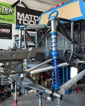

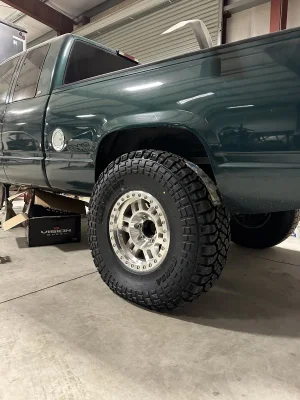

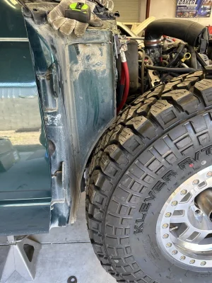

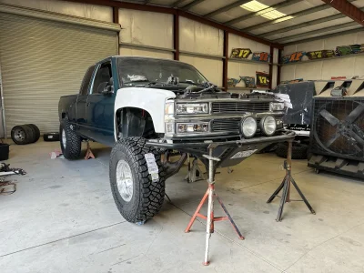

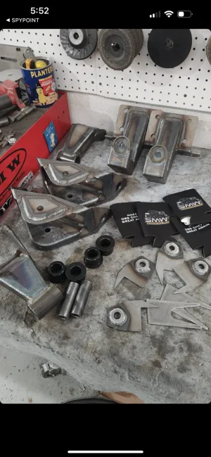

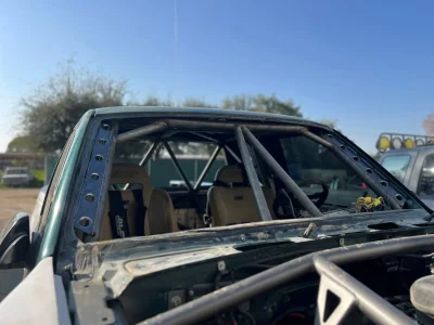

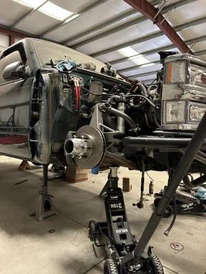

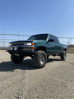

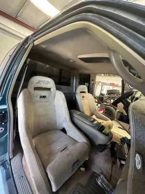

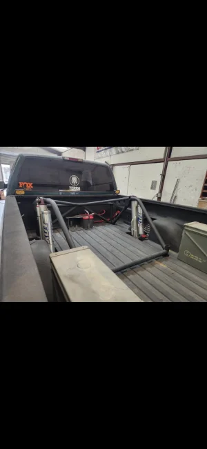

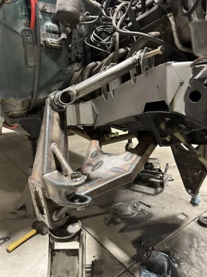

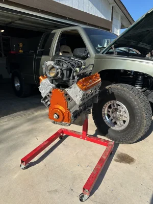

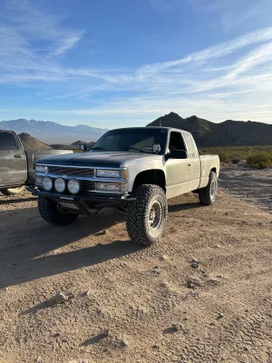

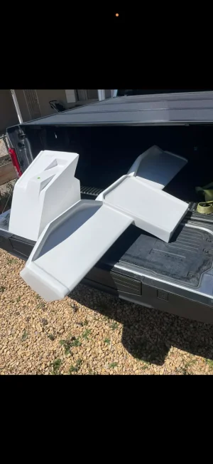

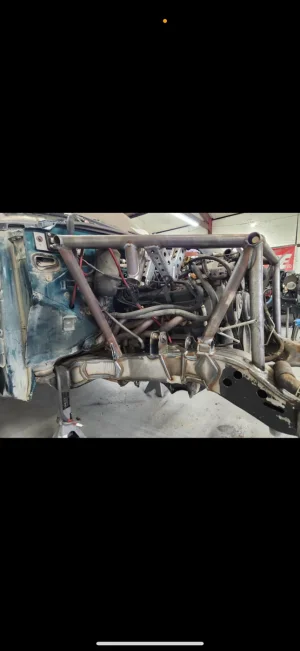

Currently in process of my obs Chevy prerunner/prelander build

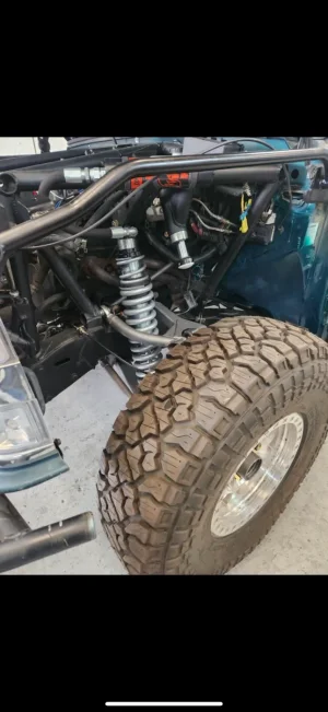

Front kit: Schumacher metal works (hybrid long travel kit) 3.5” over per side, 17” travel, Dana 44 snouts and hubs, wilwood brakes, fox 2.5x10 coilovers, 2.5x10 bypass, 2” bump

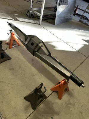

Rear: C85 leaf under, Schumacher metal works hangers and shackles, 3.0x16 fox bypasses
Wheel and tire: 17” vision beadlocks and 37/12.50 kenda r/t

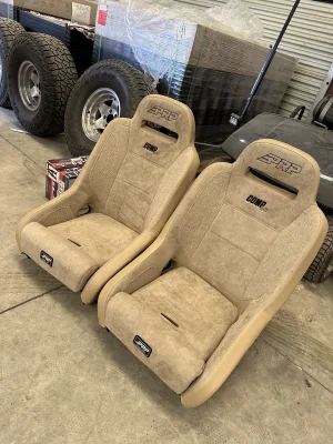

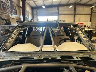

Interior: prp comp elites, atomic fab seat mounts, full interior and stereo, tons of dynamat
Bumpers: baker fabrication rear bumper, custom front
Fiberglass: adv front fenders
I know these obs Chevys are not real common for building due to the lack of support and the weak frames. But they just look so damn cool when done right and the early 2000s feels for days. I’m definitely trying to keep a old school vibe to the build while also blending modern tech and a prelander. Can also follow the build on ig @nick_presson_k10
