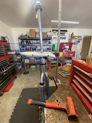

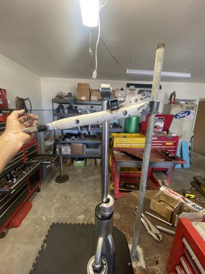

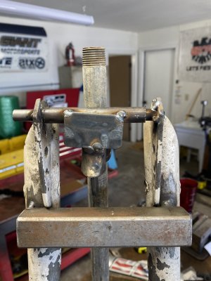

These bigger shocks are hard to get the shaft assembly out or compress the seal block back in, so a took part of adjustable wood clamp and hinged some BMX forks as a leverage bar but it’s adjustable for a different shock lengths.
