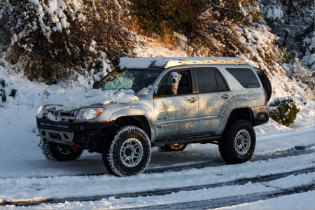

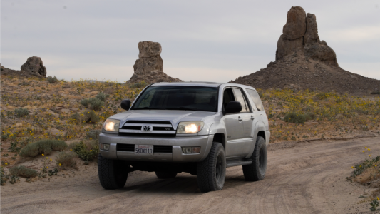

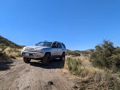

I was really missing wheeling due to my main rig being under the knife for so long so In 2024 I bit the bullet an purchased my 2004 Toyota 4Runner for $9250 w/ a 2UZ V8, 4WD, and 217k miles on the odo:
Since I had worked on so many Toyotas at this point I pretty much knew what I wanted out of this thing. An all around daily driver do-everything rig that I could take camping comfortably with the wife and dogs yet still be capable enough to hit some solid trails.

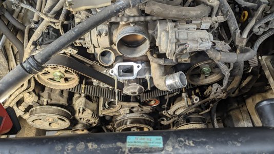

I opted for the V8 for the legendary reliability. If anyone isn't aware this is the only gen 4Runner that offered a V8 and it's the same one available in the Tundra, Sequoia, and some Lexus' at the time. Really the only things you need to worry about on these rigs is the timing belt and transmission oil pumps, both of which can be fixed with proper maintenance. So that was the 1st thing I did: transmission flush, filter, and external cooler along with a new timing belt/water pump and other misc. maintenece items:

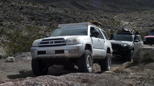

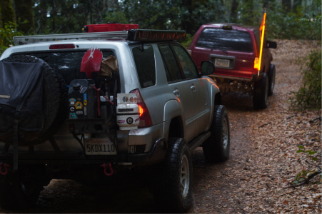

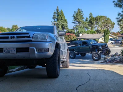

I also needed some new tires so I opted for some Falken Wildpeak A/T3W 285/70R17's. This is a rare image of both rigs running at the same time:

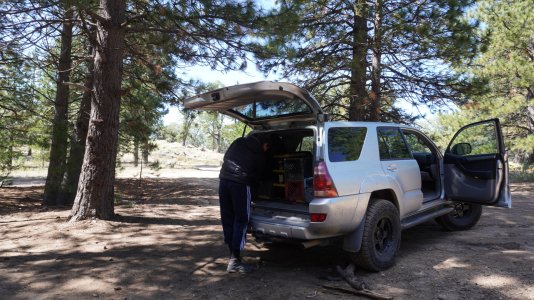

1 week into ownership we decided it was time for the maiden voyage. The wife and I took it up the 395 to some of our favorite camping spots. I really wanted to feel it out and start the build where I felt it needed it the most:
And what did we learn? Well 1st off my wife, who was eager to drive the new vehicle, went full prerunner status right into a mud puddle, smashed a rock, and flattened the cam tabs. No biggie, I happen to know a guy who makes the solution to this issue :)

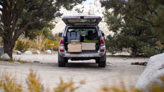

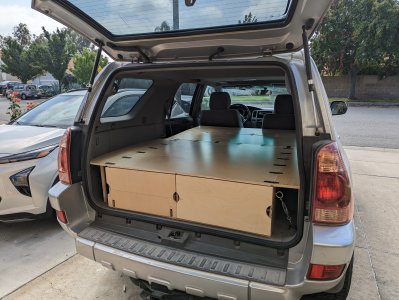

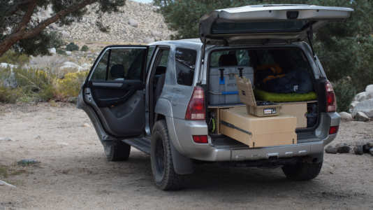

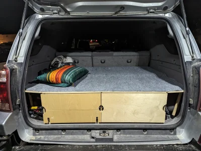

I was originally stacking all my gear in crates like I did in the Taco but with the enclosed cab was thinking why not build a drawer system/sleeping platform?

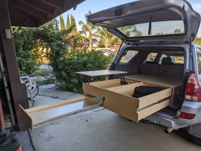

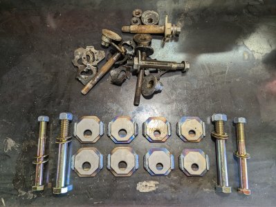

When we got back home I got right to work on the drawer system and fixing those bent cam tabs:
I opted to use 1/2" Birch pre-finished 7-ply plywood as it's strong and quite a bit lighter that 3/4" plywood. I didn't have any plans and designed the whole thing from scratch which worked out because I was able to make it exactly how I wanted. Originally I designed the sleeping platform to unfold like an accordion but I realized I never used the rear seats anyway and I ended up making the bed a bit more permanent later down the line:

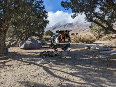

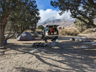

The next trip was a solo run up the 395 again (you'll notice a theme here). I was really excited to test out the drawers which worked exactly how I envisioned them:

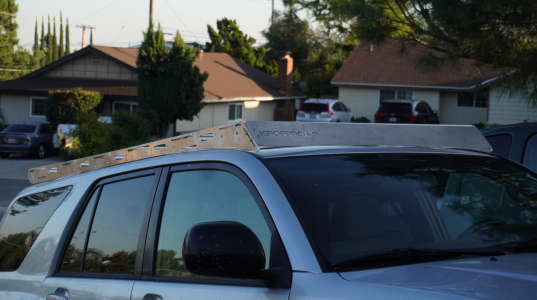

I had also realized another issue, with the closed cab it made it really hard to bring spare gas, propane, or firewood. I didn't really want any of that floating around where I was supposed to be sleeping. I ordered myself a Nguyen Works rear bumper and started working on a roof rack which I designed in SolidWorks off a 3D scan of my roof and had laser cut:

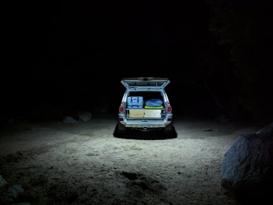

I also added some tailgate lights to the setup to make cooking in the dark a bit easier:

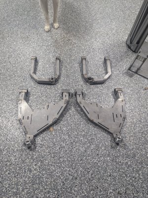

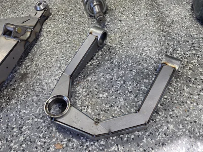

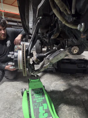

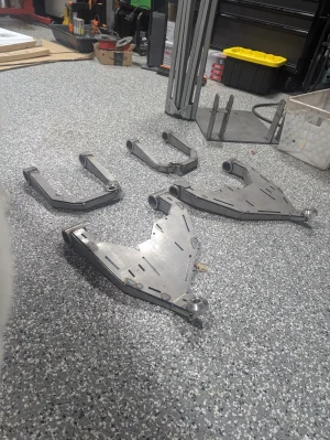

I cruised around with that setup for a few months while I waited for a long list of parts to arrive including:
  • Nguyen Works rear bumper

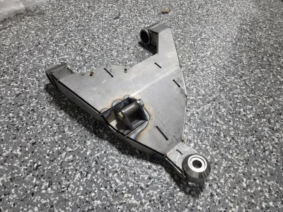

  • Solo Motorsports upper and lower control arms
  • Solo Motorsports UCA double sheers
  • DRT Fabrication body mount relocation
  • Locked Offroad front shocks
  • Dobinson 701 rear springs
  • New CV axles
  • New front wheel bearings
  • Inner and outer tie rods

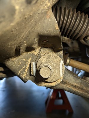

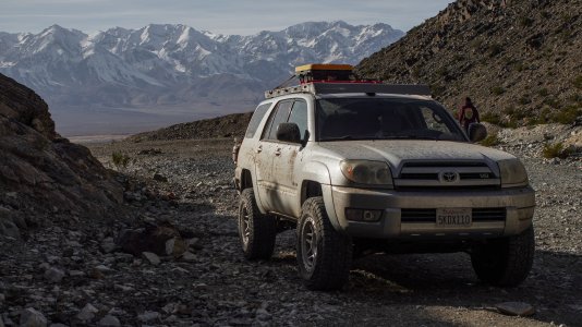

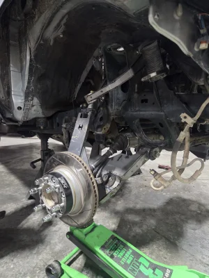

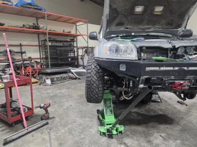

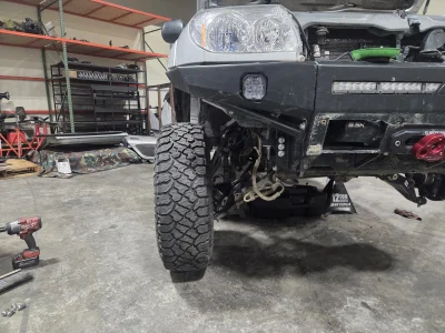

I was invited to go on a trip through Death Valley with some friends and there is nothing like a deadline to motivate you to get your truck dialed in. I waited until the week before we left to start working on the thing. I don't have many pics of the work as I was cranking to get it done but it was pretty straight forward. The part that took the longest was definitely the Nguyen Works bumper. I also realized with the new springs the factory shocks weren't gonna cut it so I threw in a set of 5100's I had laying around to get me through the trip:

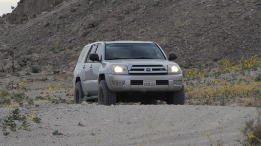

SONY ILCE-6400 4718x2655_027775.webpSONY ILCE-6400 5110x2875_027582.webpSONY ILCE-6400 5519x3106_024281.webp

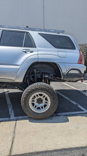

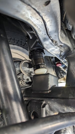

Everything worked great except for the rear 5100's. They were working as both a limit strap and bump stop the whole trip. We went through some whoops around Saline Valley and it was constant bottom out to full extension over and over again. Surprisingly nothing broke and I even sold the shocks to another person who is still using them to this day. You really can't kill a Bilstein.

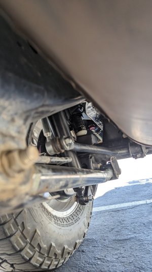

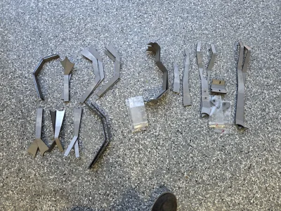

I kept the rear as it was for a few months while I waited for another long list of things to show up including:
  • Dobinson upper/lower rear links
  • Locked Offroad 10" smooth bodies
  • Locked Offroad hydro bumps
  • Front and rear 4.10 gears
  • 3rd gen 4Runner elocker 3rd member
  • Eimkeith lower link skids and link reinforcements

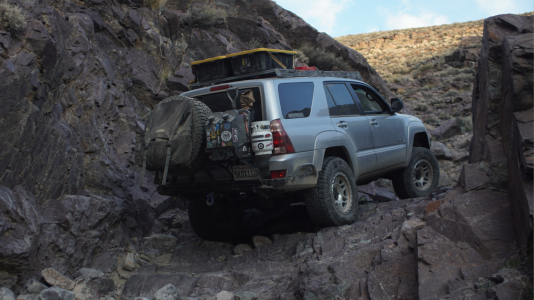

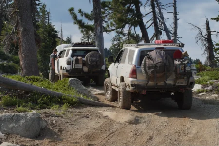

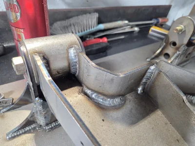

Once again I was invited on a trip up north to Gold Lake above the Tahoe area and once again I waited until the week before we left to start on the rear. I cranked out the regear and elocker install while my buddy dialed in the suspension. We built a small outboard shock hoop and used his bump stop kit along with a custom panhard bar to get the flex we were after:

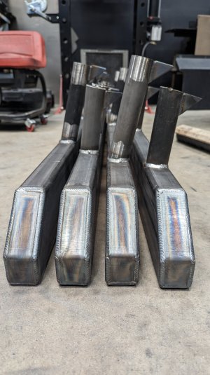

We also built some rock sliders for both his truck and mine knowing this trip was gonna involve some crawling:
We made it on the trip and the truck performed beautifully! The elocker came in very handy along with the sliders and all the extra travel from the rear setup (somewhere I have more pics but my failed hard drive hid them somewhere):

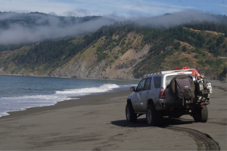

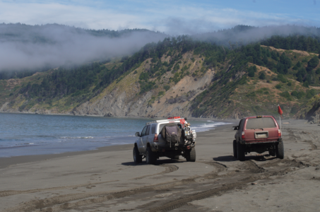

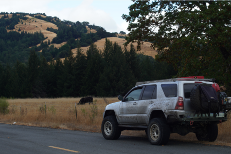

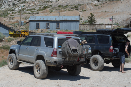

I didn't change anything for the rest of summer and did 1 more long trip to the Lost Coast as well as a bunch of smaller trips up the 395:

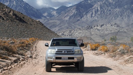

We're getting pretty close to the current setup. Last fall I took a trip up the 395 to check out the fall colors with one of my buddies. I didn't have a front bumper as I was working on the new one I ordered:

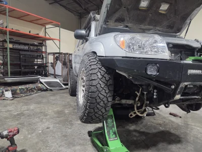

When we got back I got to work getting my new bumper assembled and installed. I went with a somewhat newer smaller company, Ascend Fabrications, and tried out one of their WIY front bumper kits. We've done lots of Coastal Offroad bumpers in the shop but we were both pretty impressed with Ascend's quality. I also threw in a 10k lb Smittybilt winch with a Diode Dynamics light bar and pod lights. I also finally had the room to go up a tire size to some 35x10.5r17 Kenda Klever RT's. To celebrate the new tires and bumper I, of course, took a trip with the wife. We hit the Mojave trail from Laughlin to Afton Canyon:
And that pretty much brings us to today. The only other thing done to it since Mojave road in February was a full overland exhaust from MagnaFlow. I continue to daily drive and camp with it whenever I can. If you're gonna spot me it will probably be in this thing with my dog:

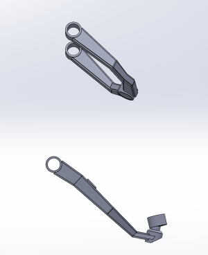

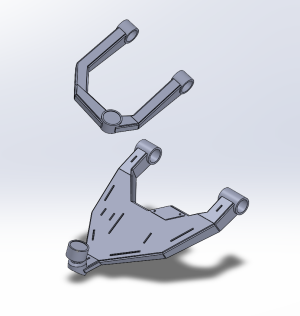

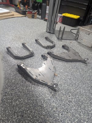

Next on the list is an FJ Cruiser transfer case swap along with a Northwest Fab crawl box. The 4th gen has one of the worst 4x4 systems in the Toyota ecosystem which is why they tend to not get as much love as the 3rd or 5th gens. Toyota plucked the drive train from the Lexus GX470 so it's full time AWD with an electric center locking transfer case. It sounds cool in theory but it causes more trouble than it's worth. I have all the parts for this swap I'm just waiting for the time to do it.

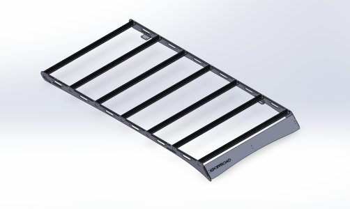

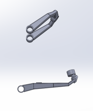

I've also been cooking in SolidWorks with a +2" LT kit of my own design which when done should have the most travel of any +2" kit on the market with ~13". I have a test kit tacked together which has already been test fitted and cycled with some King 8" shocks we had in the shop. I'm just waiting to pull the trigger on some shocks of my own so I can get this guy installed and start testing its limits:

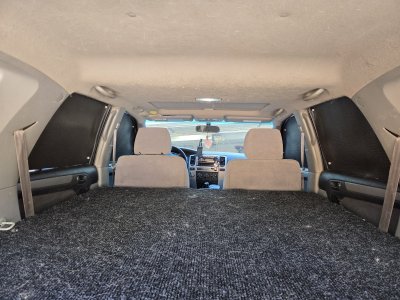

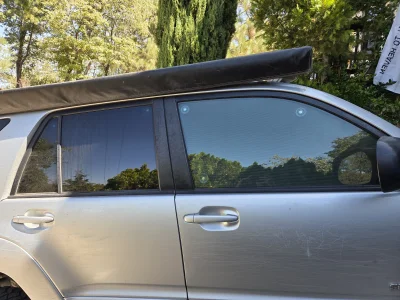

Little Saturdat morning project. When we go camping the dogs are almost always with us. One of them is a Great Pyrenees and barks at anything and everything:1000004207.jpg
Usually we're out in the sticks away from people but for the few times we stay near people I needed a solution to keep her quiet. We've tried jamming towels and jackets in the windows but they usually end up falling down in the middle of the night. I also have a front window shade but that doesn't matter when she can just look out the sides.

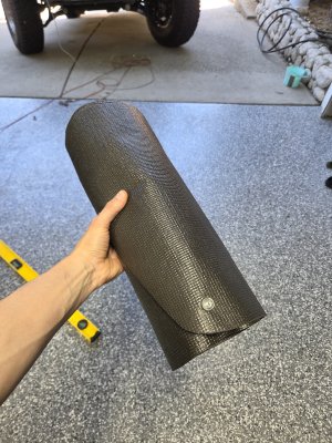

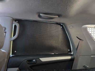

On our last trip I had an idea to try using toolbox matting along with some suction cups to make some removable window shades. I ordered everything when we got back and I finally had some time to throw them together today:
So far they seem to be working! They block ~90% of the light which will also be great for sleeping in!
When we're ready to roll out they roll up for easy storage. I have a long trip planned for next week which will be the perfect test run for these:1000004211.jpg

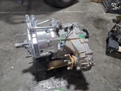

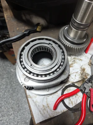

Had some free time and decided to throw together the NWF Crawl Box:
Building it was pretty straight forward and super fun. I would consider it the modern version of the Marlin Crawler box as it uses the reduction planetary gear set found in nearly all Toyota chain driven transfer case. The only downside to this kit is that you need a donor case for the extra reduction gear set and some misc parts. You can also get the parts new from Toyota but you could easily spend an additional $500 doing it that way.2f47b83d-4c1c-4938-ab7d-ddd0bb788df7.webp
NWF claims an electrically actuated t-case wouldn't work so I used a J shift from a 3rd Gen 4Runner as my donor case. The J shift cases cost more as it's the better option for wheeling and much more reliable. Swapping out the e shift case is a very popular 3rd Gen mod. I later learned one of my buddies used an early electrically actuated one in his build, so it may actually be a year range issue. Reguardless, I only spent $150 on the J shift case so not bad at all.
I was also told I had to use an FJ Cruiser t-case in the rear for the correct bolt pattern. The NWF crawl box has clocking holes (which is super cool) so the box is actually 2 pieces. After building it I think it would be possible to use the front half to bolt to my transmission and replace the back half with the part that bolts to a 3rd Gen 4Runner t-case. Even J shift 3rd gen cases are WAY cheaper and much more available than the FJ Cruiser ones are (I spent $450 on my FJ case).
I opteded for the DIY shifter kit as the 4th gen doesn't have any sort of shifters. It's funny, they just send 1' lengths of rod with a threaded end. Bending them and cutting them correctly is all up to you.
I'll get this thrown in soon. It requires modifying or building 2 new drive shafts. I'm also toying with throwing a Ford 9" in the rear which would also require a new/modified drive shaft. I haven't blown up a Toyota 8" yet but this would delete the AWD system on the 4th gen finally giving me 2WD for burn outs and with the insane power of the 2UZ I know it would only be a matter of time before something pops.

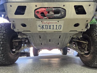

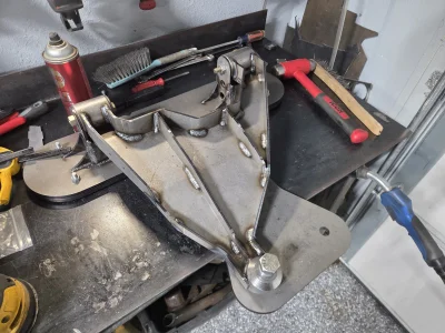

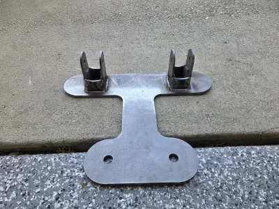

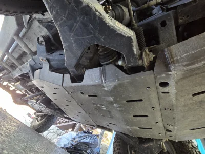

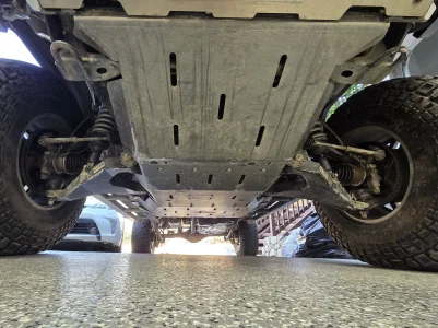

In other news, I FINALLY have some real skid plates!
I'm super proud of these, the fit and finish was phenomenal for a 1st run! I designed my own because I'm running an Ascend Fabrications front bumper and I noticed it had the perfect mounting holes for some skid plates. Most aftermarket skid plates bolt to the front crossmember which is about 3" behind the bumper. I didn't want that gap and I wasn't a huge fan of the design on many of the aftermarket skids available.

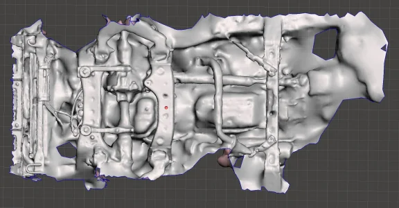

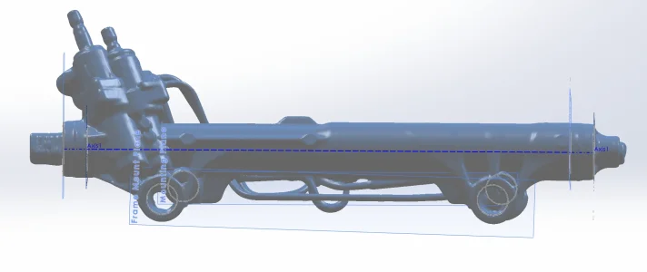

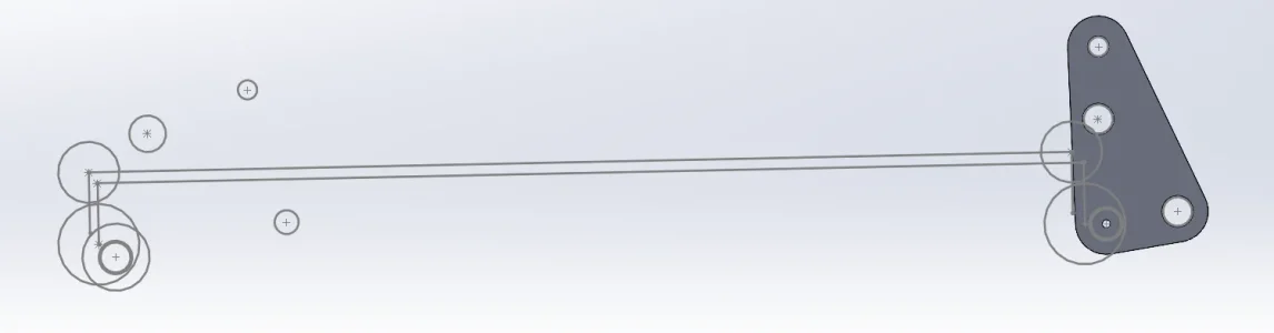

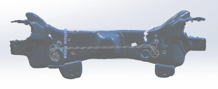

I started designing it out of carboard but I wasn't happy with how it was turning out. I decided to try out my phone for a 3D scan. Now the phone only takes photos so dimensions aren't recorded and the quality is pretty low. It was up to me to scale it right and hope the blobs were close enough. Here was my final scan result:

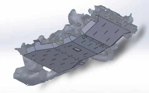

I imported it into Solidworks, added some planes, and got to work with the design. I was on a bit of a time crunch because I had a Dishpan Springs trip planned in 4 days. I spent a full day designing it and sent it to our laser cutter with my fingers crossed:

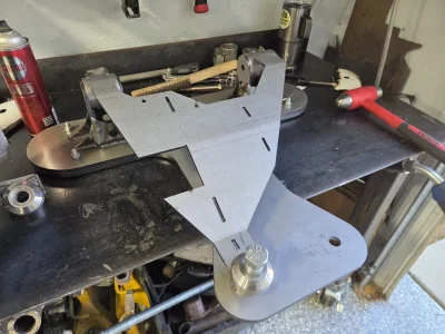

I've installed dozens of skid plates and I had some ideas on what I would change to make install easier. On my skids, each section is modular, meaning you can run each section on it's own. Because of that they are also each removable without touching the other sections. Many skid plates require at least loosening the other sections to remove the one you need to. No new holes need to be drilled and all the factory frame mounting bolts are recessed so even if the connecting bolts get damaged they are still removable. None of the pieces overlap and it's tucked about as far up as you can get. I got everything cut of 3/16" steel:Capture3.JPG
I didn't have time to finalize the mounting system before I sent it to the laser cutter so I made all the holes smaller on my set so I could drill out what I needed to. I was a little stressed with the time crunch but then I remembered I own a fab shop, who cares if it's not 100% complete in the CAD model. I did finish the mounting system later in the day but by then the plates were done. The laser cutter forgot the ribbing but by the time I realized he had already left for the weekend. No big deal, I need to pull them out to paint them and I'll add the ribbing then.
I was surprised when I only needed to wallow out 1 hole by about 1/8"! Everything else fit perfectly which was a huge relief because that meant my scan was accurate. There are a few changes I'd make in V2, but for now these are perfect!

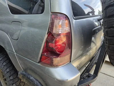

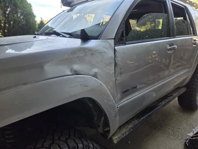

I gave them a trial run on Dishpan Springs and they held up great! The biggest issues I had was cracking a taillight and taking out a fender and mirror:20251026_111029.jpg
I'll be running these forever and due to how I designed them I can always swap out the test set with the final versions as I go. I'm also going to swap out the button heads for nice fender washers and some recessed screws. I'll also be designing a t-case/fuel tank skid. I have some ideas on the design, I just need to scan the frame and start making them.
Overall 10/10 project!
oooff! I need to get up to big bear soon haven't run dishpan or john bull in forever . What happened on the fender? The one main waterfall I'm assuming ?
The skids look solid! Super clean I like the speed holes. The Pelfrey skids I had on the Tacoma had an inch of dirt and mud trapped under there after a few years of wheeling. This will let it out and help shed a little extra lbs
Let me know if you do, I quite literally live on the entrance of Dishpan!
Some (me) would say it was my spotter having an off day, others (my spotter) would say the 4th gen is just too big. But yea, it was the waterfall section. It's much more dug out then I remembered it being but we both made it through no problem (minus the fender).
Thanks! I added the holes originally to help with cooling the trans and engine but they definitely help water and mud escape too.
