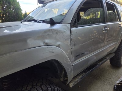

And what did we learn? Well 1st off my wife, who was eager to drive the new vehicle, went full prerunner status right into a mud puddle, smashed a rock, and flattened the cam tabs. No biggie, I happen to know a guy who makes the solution to this issue
