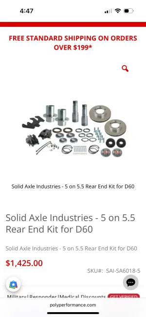

You want the cheap route or the expensive route. I can advise both. Cheap route solid axle industries 5 on 5.5 rear hubs, snouts and bearings. They will fit 35 spline, or you can bore them on a lathe or buy the same part from ruff stuff. There’s two routes to go with solid axle industries front double splined axle shafts and drive pucks similar to a drive plate from kartek or use good old fashioned flanged axle shafts which are 70-% cheaper. Both are full floater.
So one version you use weld in ruff stuff snouts with double splined axle shafts about 900$ a pair for the axles, or…..
D60 rear snouts, flanged axles at 350$ a pair. Hubs same cost, drive pucks additional cost, bearings same cost.
I can build a full float flanged axle shaft version for around 2400$ with wilwood 4 pistons part cost only. Look into solid axle industries products I can steer as needed. Good luck.

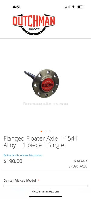

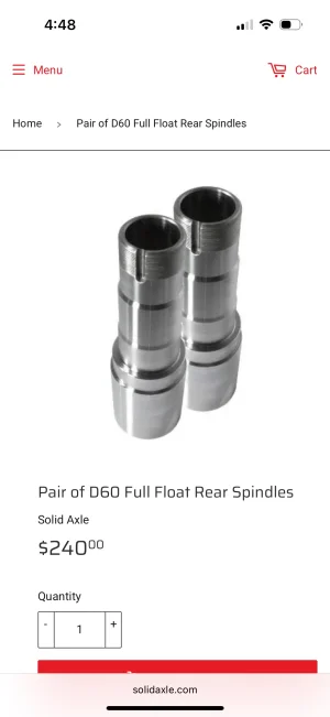

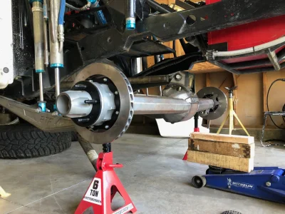

Here’s some pics to explain the contrast I described above in last comment. First is front hubs used as rear, with drive pucks and is used with axle shafts splined on both ends, very similar to a drive plate style like Pro-am or Jamar.
Second is rear hubs used as rear d60 with flanged axles. Both are true full floaters as the load is spread to hub bearings vs axle shafts in both cases. The only thing I haven’t searched up is 40 spline flanged axles. 35 spline are cheap cheap.
One last note, your standard autozone d60 spanner socket will need to be turned down by about .050 to fit into the flanged hub to tighten the spanner nuts.
Speedway engineering is an option as well that’s pretty affordable with their grand national series full floaters but your back to added cost in double splined axles shafts. Hope this lends some clarity to my earlier comments:
