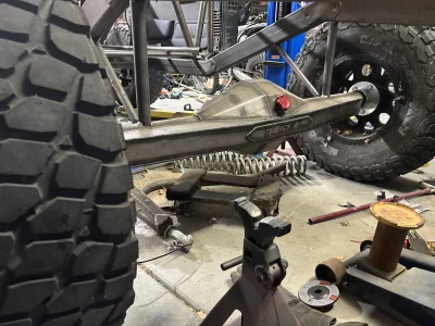

I’m 99% sure the 14 bolt rear hub and d60 snout are compatible as Solid axle industries only sells one type of weld on snout. I assembled one recently and it’s all worked out fine. Customer broke his leg on his dirt scooter so we rolled it out while he heals. He had not yet decided on brakes, so it’s slapped together to roll in the pictures.

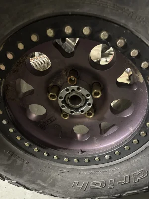

The one downside of attempting to use 14 bolt rear hubs as rears is using 5/8 or larger studs. Studs are pretty tight to the hub at 5 on 5.5 stud circle so lug nut choices get interesting. Impact socket will not fit. As you can see in the pic relieving hub with an endmill would take the meat away from the flange bolt circle. So the drive slug version might be a better choice of running 5/8 or larger wheel studs.
It’s all good info to know before anyone goes this route.
Whose rear housing is that? Im pretty sold on the 14 bolt hub idea!

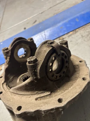

If you have the ability to machine e bearing housing pucks and third member picked and get a ground bar tkk on pads through you know she is straight as an arrow. Let me know if I can help. I only have 40 ton press for axle straightening. Might need to go to the big dogs if I do t have the tonnage to help.
Pucks pucks. Typos:
35 spline pucks installed for ground bar

But yes 5 on 5.5 becomes hard for clearance reasons when using flanged axles shafts that why most guys use rear snouts 14b, front hubs ad drive pucks when converting to D609 style vs aftermarket with true drive plates. Hops this helps. I know it’s a lot. But at least I can warn of pitfalls where I have experience.
