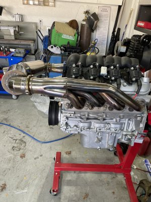

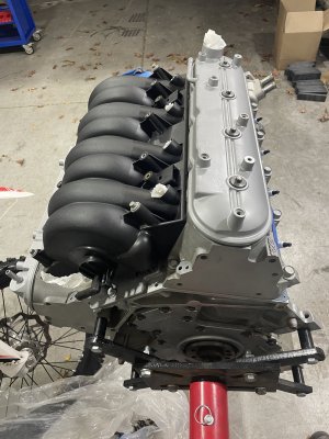

I started with the engine because, where else would you start? The block is a 6.0 liter LS2 with the LS3 crank, LS2 rods and forged pistons and 823 LS3 heads. With the Summit racing 8710 cam it should produce right around 540 hp.

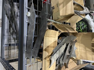

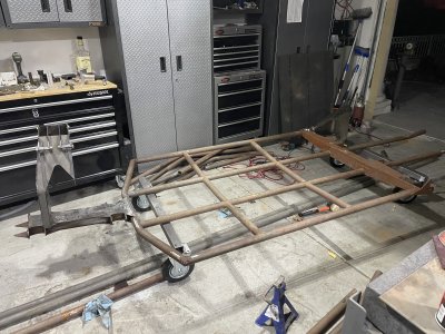

The jigsaw puzzle coming together. That Everlast welder better ever last me because we have work to do.

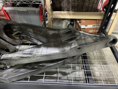

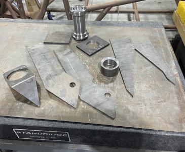

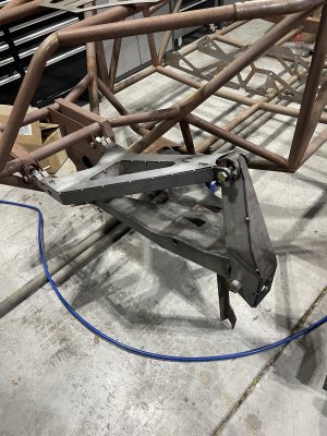

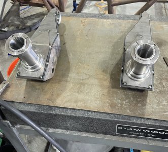

Went to Kartek and bought these spindles only to find out that the design was for some other diameter. Shit balls, luckily I have a CNC machine that can make this hole bigger. After a quick programming and setup the hole was larger just like magic and I could finish the welding.

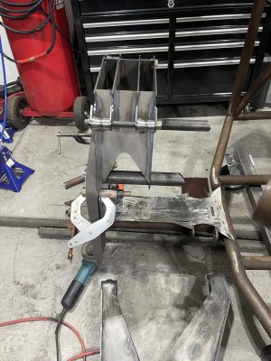

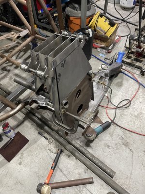

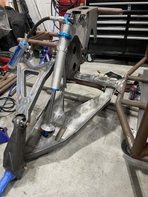

The test fit went well but where are the shocks going to go? I think he was planning on doing his own shock mounts. Since I have the files, I just sent them out to a buddy of mine and got the bulkhead laser cut.
So I started cutting, turns out this is not the last of the cutting, more to come.

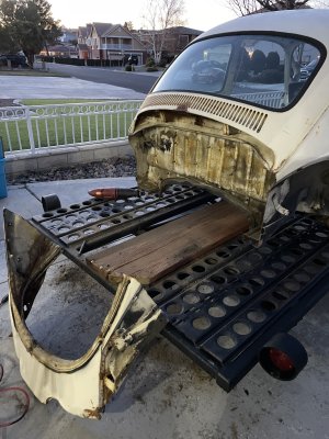

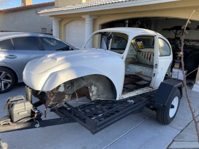

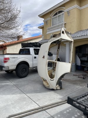

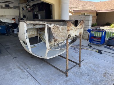

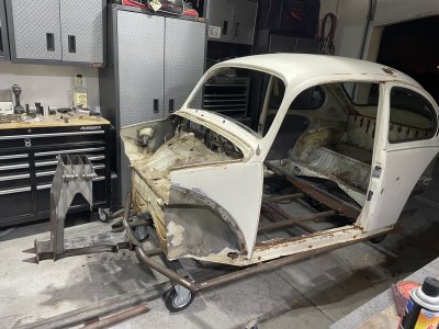

Picked up a 69 bug that will be the star of the show. Started cutting of all the shit that I won’t use.

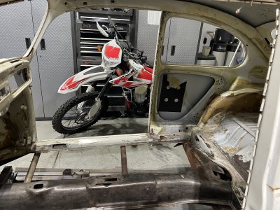

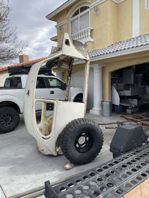

I really went ape shit with the grinder and got the body to sit pretty good on there. Lies, it fits like shit but that was expected. Time to cut more.

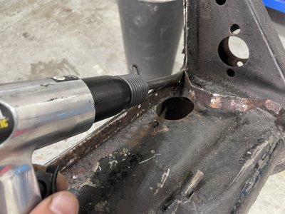

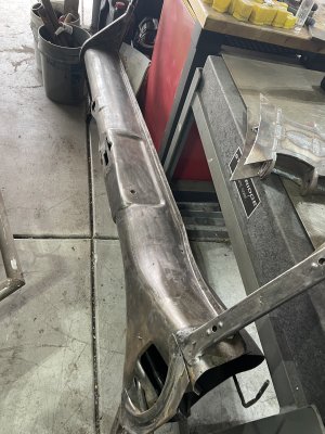

Started with cleaning up the pan to fit the tube chassis. This Harbor Freight air hammer does wonders on the spot welds. Those sauerkraut welds didn't stand a chance, they surrendered like the French.

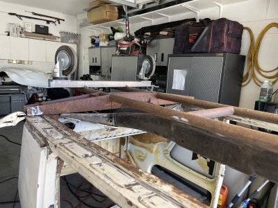

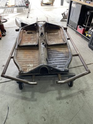

Built this sweet, super safe, made out of leftover fence material that I had laying around cradle. Flipped it over and now I can build the frame that the body will be attached to.

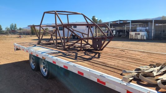

Pretty proud of this CAD design for the roll cage, I mean even the King suspension is on there.

The body is attached to the frame and the bulkhead is set at 7 degrees. Fits pretty good
