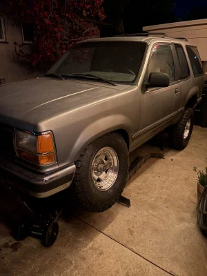

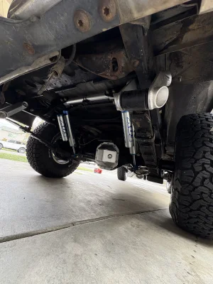

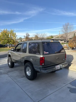

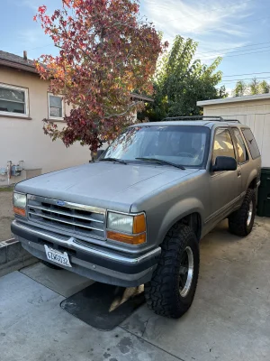

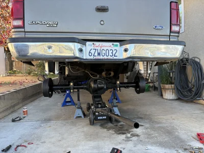

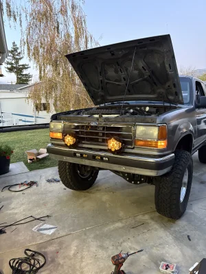

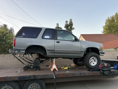

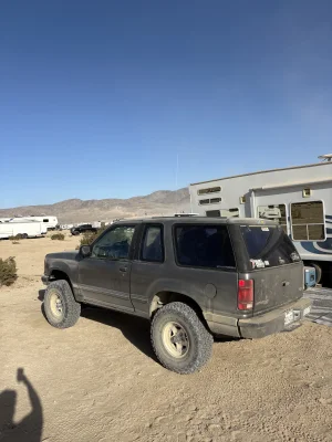

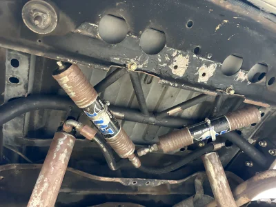

Well as many of you know I sold the ranger (Gordita) because I wanted something more “do everything” friendly, 4x4, heater, A/C, and more seats. So here she is! 91 two door explorer 4.0/4x4/manual trans/auto Tcase. Bought this thing as kind of a basket case but saw potential. It had 8” coilovers in the front with some nice solo style radius arms 6” beam pivot drop brackets
and someone had built an under cab rear shock mount. All the fab work was actually pretty decent and the price was right so figured it would be a fast and easy way to get back in the dirt asap.

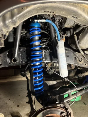

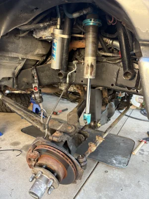

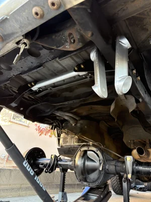

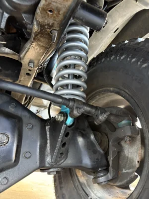

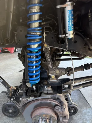

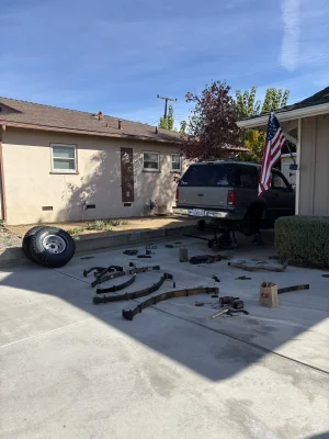

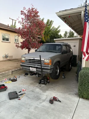

The front end camber was all fucked off because of the drop brackets and the thing only had about 1” of droop in the front once I cycled it, took some measurements and seemed like the front hoops were based off a 10” coilovers
put some stock beam pivots back on and ordered some 10” coilovers to get this thing looking right, it does not have cut and turned beams so I put in the biggest cam tabs I could find. It still kinda sits like a Baja bug

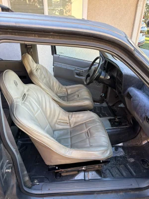

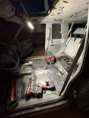

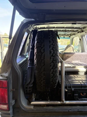

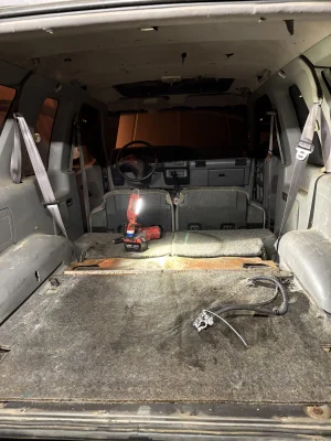

but I will get some c&t beams soon was just trying to make it out for new years! The interior was disgusting so I ripped all the carpet and headliner out

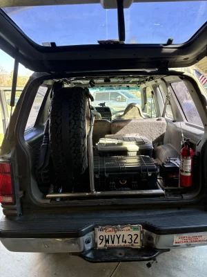

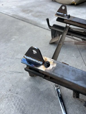

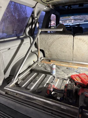

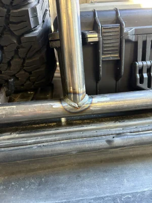

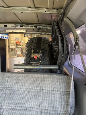

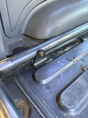

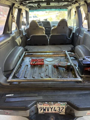

made some seat brackets on the factory sliders

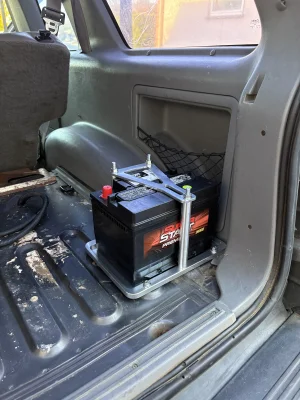

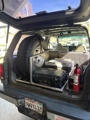

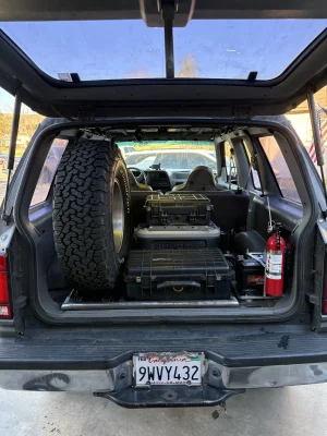

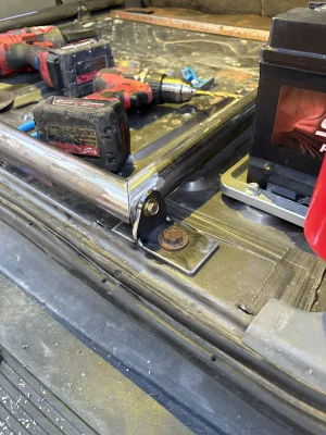

Mounted the battery cause it was just chilling in the back

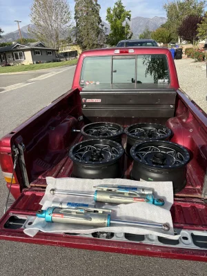

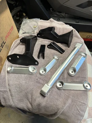

got some cool parts from Ryan @cookcraft !
New wheels and tires

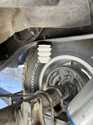

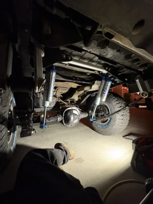

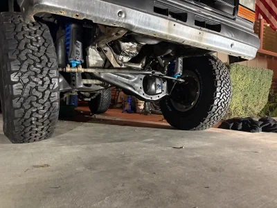

got the new shocks in and cycled, it’s not perfect, I could gain another 1” of up travel if I move the mounts but I will eventually do the cookcraft shock hoops with the c&t beams and she’ll be dialed!
Fancy shock shaft guards I had on the ranger too

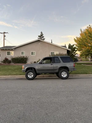

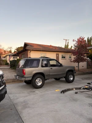

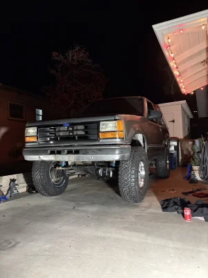

thing is already looking so much better!

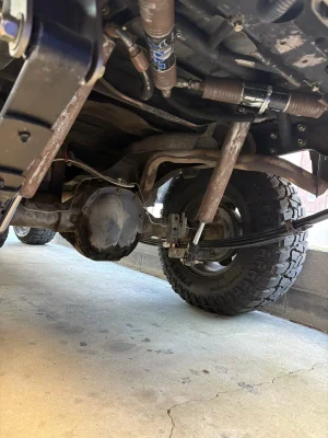

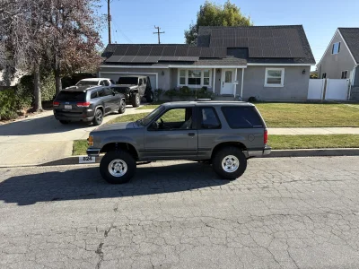

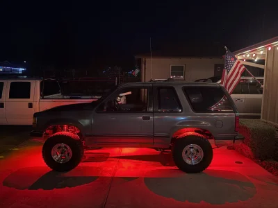

Still sitting too high in the rear with the original setup that it came with.
