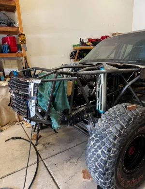

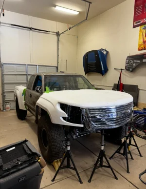

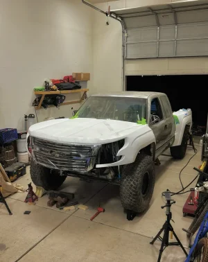

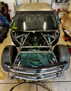

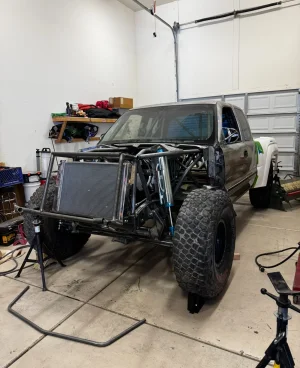

I have to clearance the passenger side still. The driver side I did already. This kit the way I cut a few things down ended about just over 2” forward from stock. 90” width with a 136” wheelbaseyou and @Pictafiedesign are having a low rider battle!! lol
Always dig seeing trucks at full bump... looks great. And damn, tires must barely clear the cab when turning!!

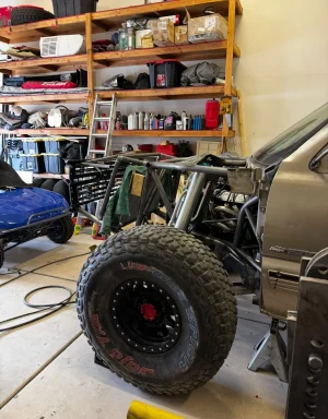

IT'S ONLY 69 FEET TALL.truck is awesome, but i am really drooling over the size of your garage
Thanks dude. I moved the boat for the winter so I can work on the truck on that sidetruck is awesome, but i am really drooling over the size of your garage
Thank youThat’s such a mean looking front clip!
Thank you Geoffso cool!

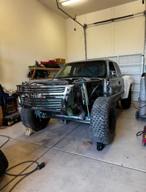

Yes I used 2” .188 tube. I’m not a fan of boxed frame horns. I like simple and needed a spot for the radiator to sit as well so went this direction.View attachment 33489
Did you gusset the tube under that rag with a square piece of tube instead of making boxed frame horns?
