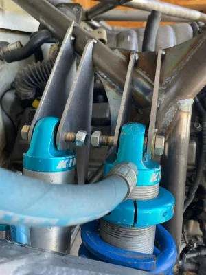

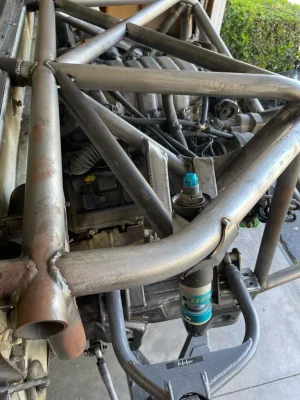

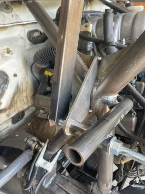

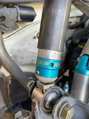

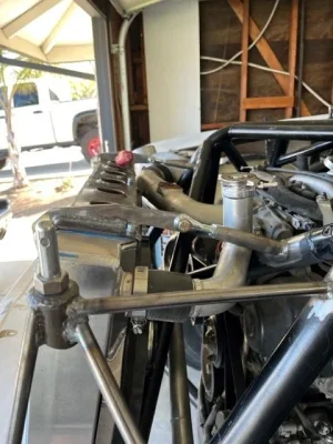

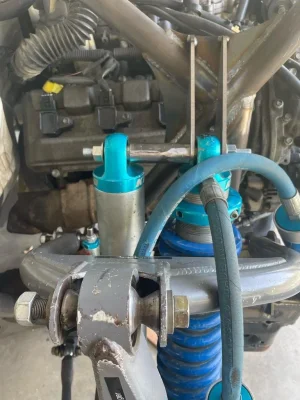

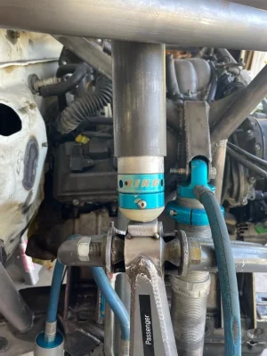

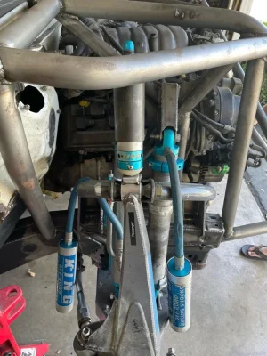

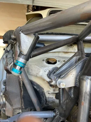

Finished up the shock mounts on the passenger side and just about wrapped up the driver side. With the extra clearance on the upper arm I was able to get the kit to cycle 18” metal to metal clean with no binding on uniballs or tie rods. I will strap it around 17”. Before the crash the kit was bumped and strapped at 15 3/4” because the truck was originally built with the inner fender core supports intact which limited bump travel.

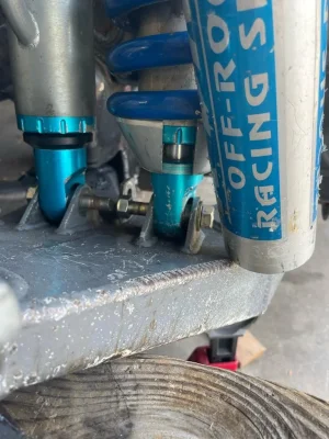

105* Garage update: Set up and mounted bump stops. On the old front end the bumps were off the lower arm. On this revision I wanted to move the to bump off the spindle the “correct way” according to shock tuners. Built a small strike pad for the spindle upper uniball cup and cycled the arms to check the scrub with was minimal with baby 2”x2” bumps.
Mounting Cans…. Hopefully they don’t shrink to much I stayed below the machines lip inside the can this time.

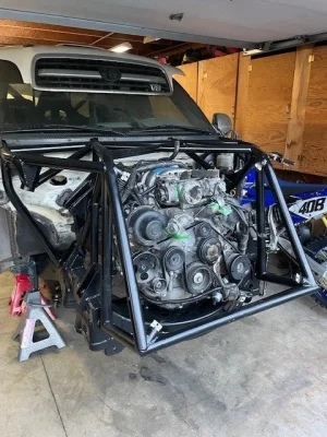

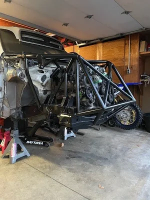

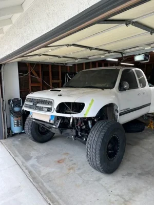

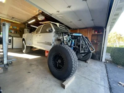

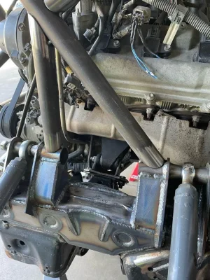

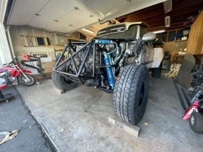

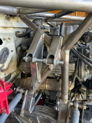

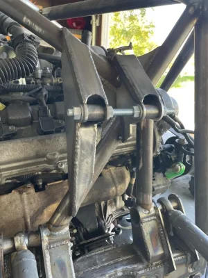

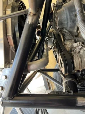

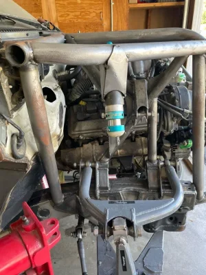

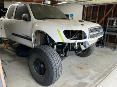

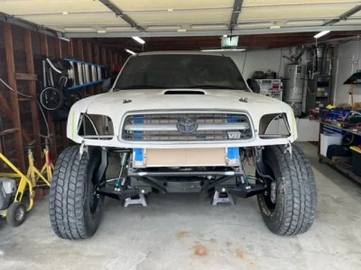

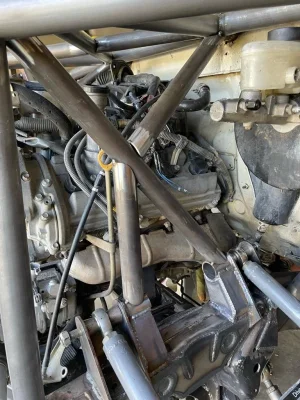

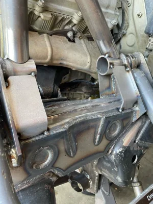

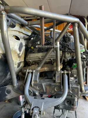

Small Update. Finish welded the entire engine cage inside and out. Put the engine and trans back in for the last time which i'm super pumped I was able to get the engine and trans bolted together to fit threw the front X that is removable. Before putting the engine and trans in tho I painted everything (rustoleum semi gloss black). I then had the control arms and uprights sand blasted to repair a few cracks on the lowers and have camburg replace the brake tab that was ripped off in the crash. Took it to Camburg because they have the fixture for the upright and it saves me from having to align it. Cost me only 100 bucks and they had it done in 30 min. I then did a full prep on the arms, uprights and front hubs. Bolted up the kit, shocks, steering rack, and everything else to make it a roller. The truck will stay in this state for a while as I just bought a house in Corona and will be moving in 20 days. Goal was to get it together enough to move it easily. Far from done tho.

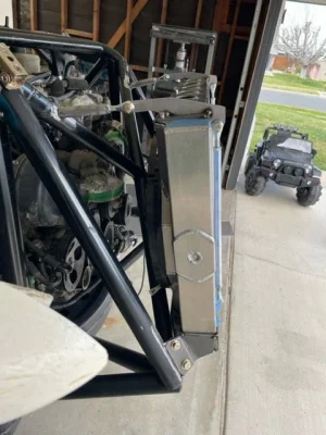

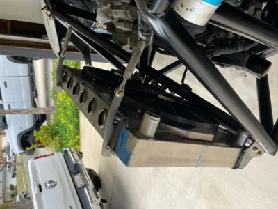

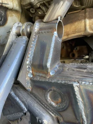

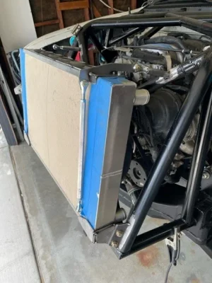

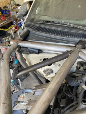

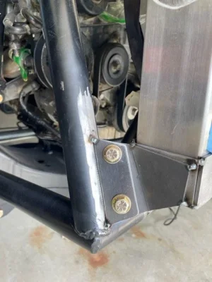

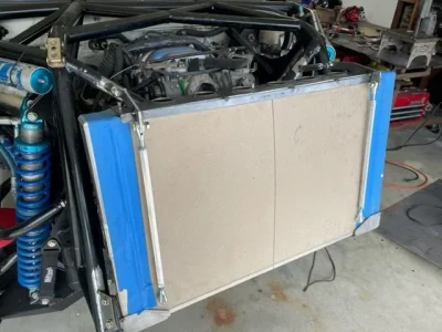

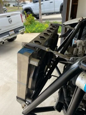

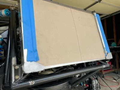

Anywho I finally mounted up the radiator its a CRB 31"x19" saw the mounts done like this on one of Ocho Fabs builds so I tried my hand at it. Very pleased with the result tho not as elegant as Cho's. I pushed the radiator as far forward and up as the hood and grille would allow to gain as much room for water lines, Intake tube, ect....

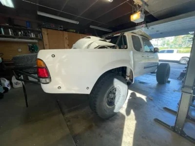

Update: I got the new trailer products 6" glass trimmed and mounted. Fit like absolute shit very disappointed in the quality of this glass.

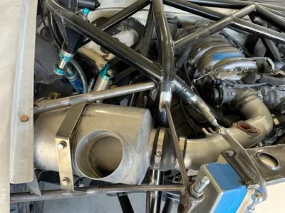

Mounted up my UMP air filter canister pretty much in the only spot I could were the tire would clear at bump and it wouldn't interferr with the headlights.

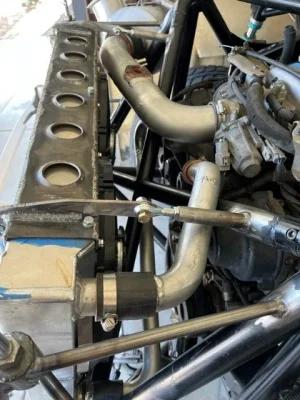

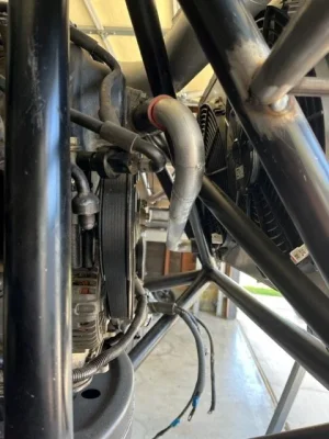

Finally I reworked my aluminum intake tube to fir the air filters new location. A buddy of mine made this a couple years ago when I built the original engine cage he made a custom boss for the factory MAS which worked out great also welded in a couple barb fittings for factory vacuum lines. I was stoked to be able to use that portion of the tube and just have to cut the bends off and rework it. Made 2 new aluminum waterlines as I am using a generic CBR radiator with the outlet on the wrong side. This was my first time tig welding thing aluminum tubing so the welds are nothing to write home about BUT I did pressure test them to 15PSI and have no leaks.
Do you remember the approximate settings you used on the welder? I need to do some tube fab like that and have no clue where to start.
