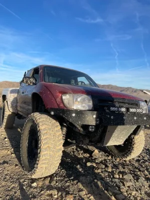

Truck did awesome. Drivers side CV nut at the wheel bearing came loose and had to get snugged back up. I could feel it through the steering wheel. Second time this happened, the little Toyota retainer/cotter pin kept it from getting too loose, maybe an 1/8 of a turn to tighten it back up. Red loctite?
Trans temp climbed to 210 and the fan couldn’t bring it down. When I run the fan from cold, temp never goes above 190. I think I’m going to put a hole in the bedside to give the hot air a place to escape. It just kinda swirls in the dead space behind the cab now.
