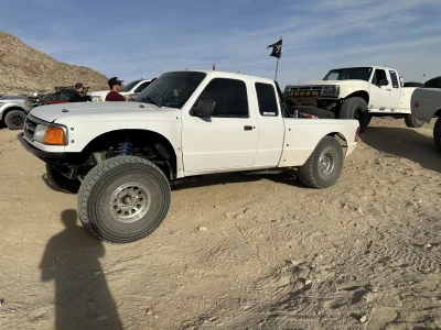

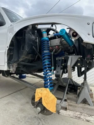

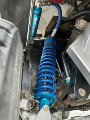

got my shocks back from dialed and holy shit they look incredible! we have a little more work to do on the tuning side.. the upper spring of the front shocks doesnt compress as much as we thought it would after adding the bump zone and moving the cop collar so far down, so ill need to swap those out for a shorter length to get my normal ride height back and some slight valving adjustments in the front also. the rear is insane, like its not even there
the truck handles so much different. before it felt like a water bed. never really harsh but would get upset in the bigger sharper holes. we increased spring rates in the rear and theat helped the truck take a hit and return to ride height much more quickly. its 'less lazy" as kevin says
the added bump zone in the front i think made the most difference. im much more confident in the front driving into big holes now.. its insane how much you can feel that area of stiffer wheel travel. much different feeling than when i hit the hydraulic bumps.

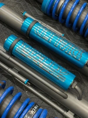

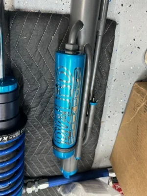

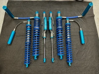

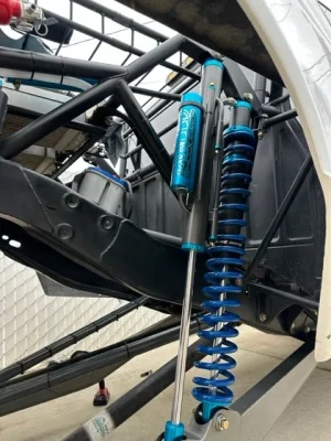

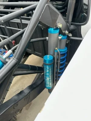

heres some pics of when they were first finished
