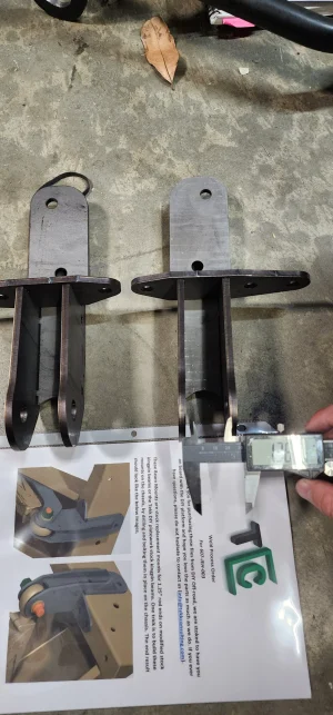

Its for this beam kit, there is no room for Misalignment spacers for the 1.25 rod end. But It takes a 3/4" bolt. So either I have to run a sleeve in the rod end to drop it to 3/4" or run a 1" bolt or, ideally find said rod end.
Yeah if you're able find some spacers that work than design the mounts to that width. Beam pivots are usually wider. Ours are 2.125" wide with 5/8 bolt for reference
My beam mounts are fairly narrow and it gets really close on the inside when it cycles. I'll try and get some measurements tmrw for you.
1-7/8 stack height with a 3/4 bolt, 1.250 heim. I dont see how it could be any narrower than this, it gets very close when cycling the beams.

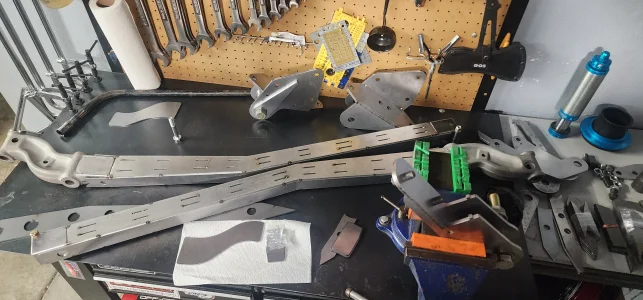

Here is some nice progress on the beams 😀

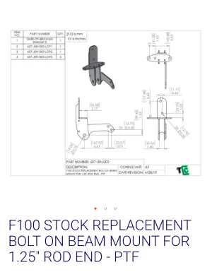

Copy, understood. I probably didn't type it out great but we are seeing that in the cad, the rod end body contacting the sides of the bracket as it cycles and the radius arm pulls the beam through its arc.
This is the bracket we are building:
Might just have to look through the menu but it’s a broken link when I use it.
