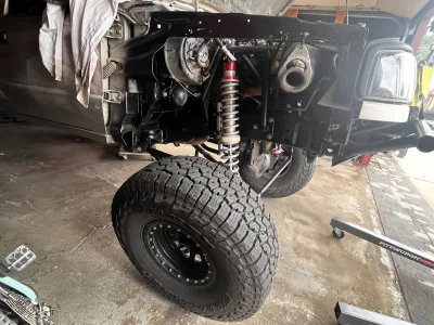

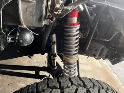

Who has pics of ibeam shock hoops on rangers that keep the AC? I’m planning to build a 97 4.0 ranger I have and want to throw coilovers on it but want to get ideas on shock hoops that work around the AC
If you have pics send them my way!
Here is some pictures of some I did on my ranger.
Perfect man thanks! Did you have to move some ac stuff around to get it to fit?
Nope! I was able to get 90* to the pivot of the radius arm and beam at full bump. I placed the shock about and inch off the front of the beam and relocated my master cylinder. The giant hoops are good for what they are but don’t maximize shock angle.
