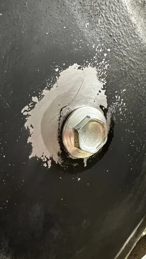

Anyone ever used the permatex or jb tank weld for a steel fuel tank? The oem tank in my shitbox has a crack near the drain bolt and can’t find one of the same size as a replacement. Also really don’t wanna drop the tank out of the thing. Soap is working for now it seems but I’d prefer a more “permanent” fix. What sauces have you slapped to get a steel tank to seal its precious tears?

So I ran Jb weld and a quarter over a crack in my gas tank for years (5 years?) Eventually, it started to leak again and I end up replacing the tank... I think the tank was only like $130 bucks or something. Was a little bit of a pain in the tits to change but it's nice not having to worry about it?
run your tank down. drain it... prep the metal really well and Butter it up with a whole bunch of JBweld.
Obviously, make sure your repair doesn't fuck up the drain seal.
If that doesn't work... get a new tank and call it a day... or even keep an eye out for a used tank.
Happy JB welding....

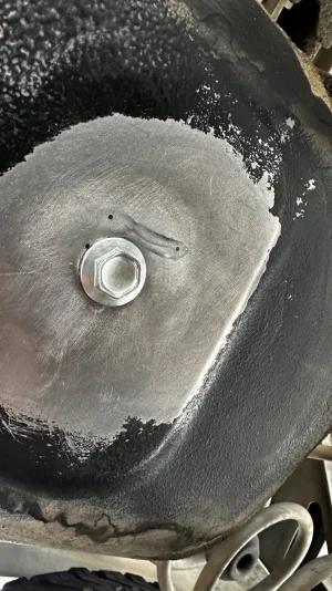

It lasted 6 hours in this rain haha. Got to work this morning and within an hour probably half a gallon was on the parking lot. Home now, gonna drain the tank and smear some seal all on there for now. I have a pneumatic drill, should I hit the ends with a tiny drill bit to stop the crack?

So did you break out the loofa and the dial? or straight for the JB WELD?
Photos of said repair?

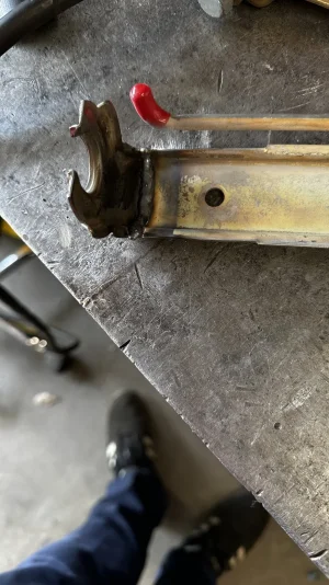

Little update, junkyards drill all their tanks out now days. Local parts authority was able to get me a new tank overnighted for a decent price so I went that route. Fuel pump bracket didn’t fit so I had to take a little off the top

Inside of the old tank looks fantastic so I’ll probably clean the fuck out of it and still wait a month and take it over to @Turboyota for some tiggy action. Not sure what caused the crack but what a pain in the taint.
