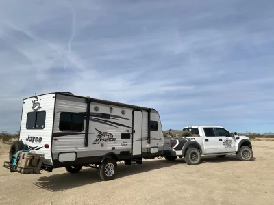

I absolutely love my 2012 Gen 1. I paid 28k bone stock. I haven’t towed a vehicle on a trailer but I’ve towed my travel trailer out to the desert quite a few times, went out and played all weekend and pulled the trailer home with no issues. I have the ICON rear leaf packs and I use a weight distribution hitch.

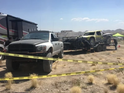

It may squat but I normally use a WD hitch. I don't care if it squats. Here's my old Dodge towing Ms Piggy with a ton of tongue weight with a Deaver race pack.
I can gurantee a Raptor has more up travel towing than my lowered GMC does.

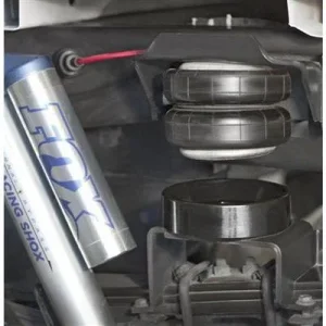

The cradles are good option too, I install a lot of those. The only time I dont recommend them is on coil sprung rear axles with a rear track bar.
Is this because it makes it hard for the Cradle to line up when it's articulating?
Yes, for street trucks with leaf springs, the axle moves forward and back a little.
But With coil sprung rears, they are moving forward and back, and side to side.
