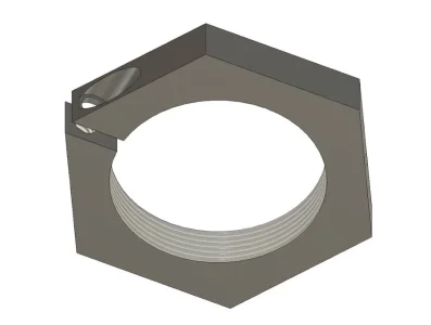

Not exactly the same as the BMS lock rings but a similar approach.. My old Ranger kingpin spindles used a threaded pinch bolt style collet as the spindle/bearing nut. Tighten it to where you wanted, then crank down the allen screw so the nut bites down onto the threads. I never had one come lose on me ever. Super simple and efficient.
If you can blast a Allen screw with brake clean, put a drop of red loctite on there, and snug it up, then idk what to tell ya haha

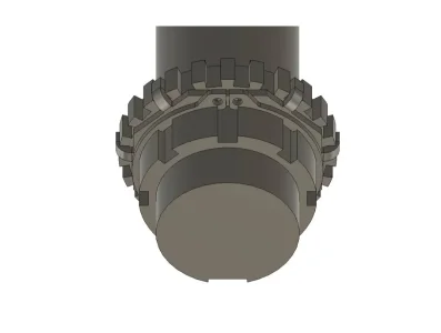

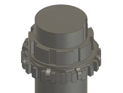

Spindle nut system modeled up. Everything is parametric. I have no clue on any of the actual measurements, aside from spindle diameter that I found online. Snap ring imported from McMaster. I copied the design of Stage8, so there are 23 teeth, meaning the external teeth on the lock ring are inherently offset from the octagon pattern. That gives infinite fitments, and I'll just need to rotate the lock ring around until it fits the spacing.
There's a good chance this doesn't happen and I just use the clamping spindle nut idea

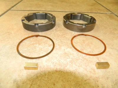

I use AAM 14 Bolt spindle nuts on my Dana 60 and 70. Easy to work on, can't come loose, the wedge goes in and the spring clip snaps on the spindle threads. Cheap too, you can find them used all day long for like $30-40 a set on Ebay, or literally any pick a part will have more than you need.
