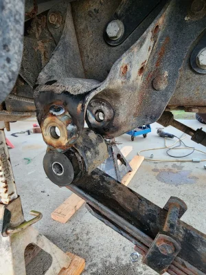

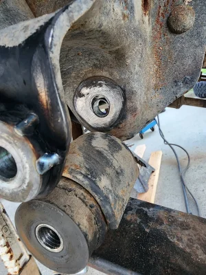

I think I figured it out... the drivers side front leaf hanger has a wallowed out hole. Welded in a weld washer hopefully that's it 🤞
