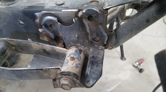

Hey everyone, I am getting a very good deal on a set of deaver f31s for my 98 ranger. Just wondering if I’ll need a wider/ different shackle or if all I’ll have to do is flip my own shackle?
Is moving the hanger back something I have to do or just something you recommend for more travel?
If you move the stock hanger back and pivot it about the lower forward hole, you can use cheap eBay shackles to get 17” of travel.
