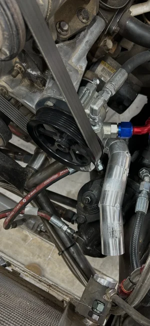

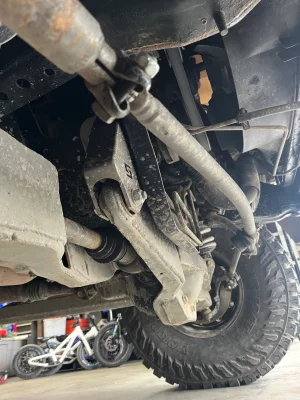

My setup:
-Cho steering
-Cho steering Howe ram assist (Built to the Cho steering specs with internal stops built in)
-PSC Desolate ported steering box
-Sweet 1450 psi steering pump (purchased at Kartek)
-Holley GM pulley (Came with the accessory drive kit)
-Howe 2" steering cooler (purchased at Kartek)
-Kartek power steering reservoir (purchased at Kartek)

My setup:
-Cho steering

My setup:
-Cho steering
Have you ran this setup? No issue with pump whine or foaming fluid? I tried a Kartek nonfiltered reservoir and it sucked lol. No baffles or anything, at rpm higher than idle the fluid would just turn to foam inside and make the pump whine like crazy. Burned up a few TC pumps
Personally I have not. But almost all the Bronco's I have helped with are running the same stuff, except for the Holley pulley.
