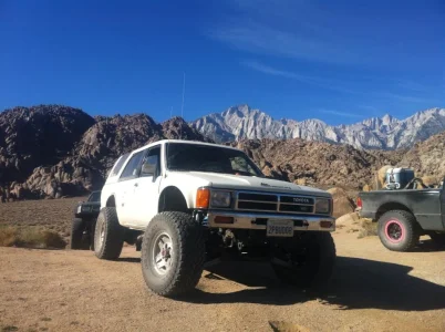

You cant go wrong with the caddy kit(s). I ran the older torsion bar kit with just an 8" bypass on my 89 4runner and it did great. As long as you realize youve only got 12" of travel and youre not rocking a trophy truck, youll be stoked.10629599_10203282051465351_5465523293671955314_n.jpg

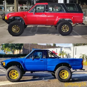

I had chevy 63s and a mix of various other springs on my old blue pickup. They weren't that great.
that, what I was thinking lol. did u run the 63's spring under or over? I'm also where people are mounting the rear shock tabs?
They were spring under since it was a 2wd.
