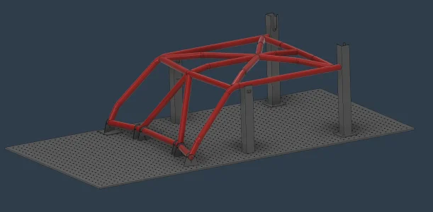

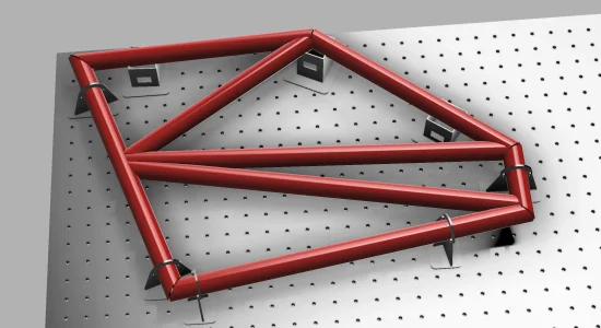

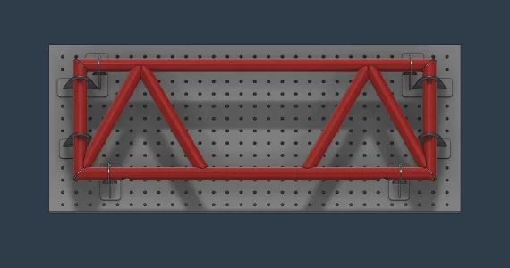

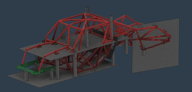

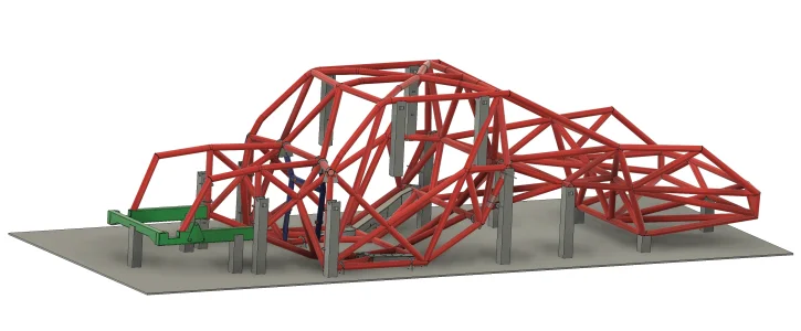

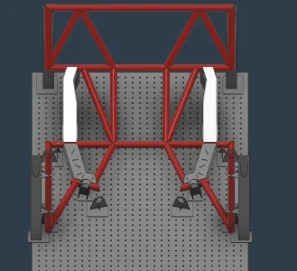

Man, making fixtures is probably the most boring thing to do. Was able to use the same 2 Tall and 2 Short posts for most of the fixtures by making each face specific to a different area. Doing my best to be able to reuse fixtures in multiple places. Just about wrapped up, just need to confirm with the shop whether the table will be 2" or 4" on center for the base plates. We are getting close, I can almost taste it

what material is that for $7K?
2” DOM, I’d add probably over a thousand more for chromoly not sure. I paid $5400 for the chassis to be cut out (not including any jigs or sheet metal parts), I don't think its the cheapest but definitely within range of what I’d say is reasonable for a one off job. To reference some production DOM “WIY” kits before taxes:

A full stick of 2" .120 DOM is $105+/- a few bucks right now.
The 4130 equivalent is $328+/- a few bucks right now.
You would be basically tripling the cost on material going to chromoly.
$7k for everything is damn good. Thats alot of material for one, but also alot of labor cost as well to get all that done.

Good to hear, thanks Christian. And yes, not sure if you saw my other message but no issues uploading a step file from Fusion for laser cutting/bending. All the shops I talked do didn’t even need me to notch/normalize the tubing since their programs do it automatically. Whatever you name each component (each individual tube) seems like programs now will also auto etch each tube instead of having to emboss them in Fusion.

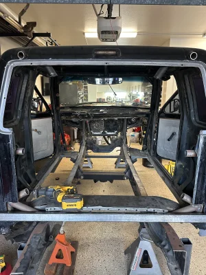

Tubing picked up and ranger shell getting prepped. Last pickup of sheet metal parts by next week and dropping off at Robert’s Custom Trucks. Jake was nice enough to rent me space in his shop to use his chassis table. Looking to have it ready by October 🤞🏽 Reusing most things from the original build to keep costs down, just gotta get it running!

I am not judging here, but I gotta ask…why not sell that complete truck if you’re only keeping the cab sheet metal? Everything is being cut off, rebuilt or replaced, and it looks like you cut up a 30k truck and you are left with a 200$ piece of cab, and some shocks.
This thing is gonna be nice! October is gonna be here quicker than you think, hammer down!!
He's reusing all of the parts from the truck to build his new one, minus the chassis.
I know right, we’ll see. Original cage was subpar to begin with, I couldn’t sell it to anyone with good conscience.
But like Kevin said basically everything is getting reused from the original truck or from parts I bought to put on the old one. Trying to keep it cheap!
