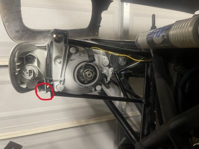

Pro tip if you're interested. Drill a 1/4 hole in this plastic tab on the corner marker and make an additional mounting tab for it. It will save your corner marker from ejecto seato cuz in the middle of the desert. They don't last long with only the top bolt and snap in tab.
