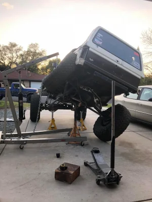

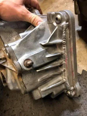

What’s up y’all, new to the forum so figured I’d throw out a quick build thread and some basic info.
I’m from northern ca, auburn area. Fordyce local. But I wheel all over (rubicon, Barrett lake, Moonrocks, niagara rim, hammers, Nv Canyons etc)
The jalopy/party wagon:

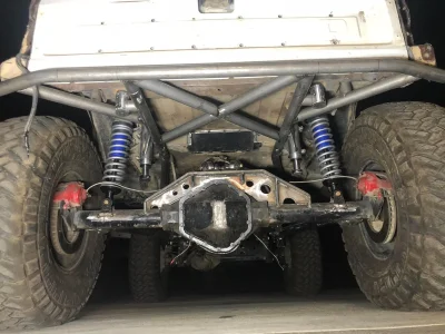

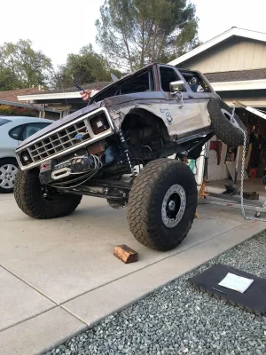

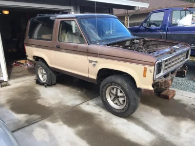

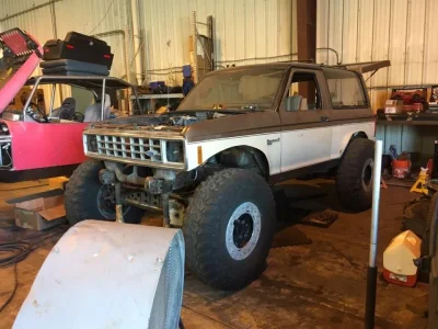

started life as a bone stock 84 bronco 2 that I got for free. Gutted it down to a frame and shell and started from scratch.
Motor: 2000 Ford ohv 4.0, stand alone harness, flashed computer, Diablo sport tuner, GMS custom maf, bbk throttle body, JBA headers.
Trans:M5od
Cases: Borg Warner 1350/54 duals.
Front axle/suspension: Ford kingpin 60, Reid’s, Yukon chromos with CTM’s, 5.38 gears, spool, Yukon hubs, partsmike histeer arms, Ruffstuff diff cover, single ended full hydro (psc ram, hiems), tube skid armor for the ram. Artec truss and link mounts, 3 linked with panhard. 2.5x14 Fox coilovers, 150/200 springs, procomp air bumps (not installed yet)

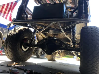

Rear axle/suspension: Gm 14 bolt (ribbed housing), disc brakes, Ruffstuff diff cover and pinion guard, 5.38 gears, Lincoln locked. Artec mini truss and link mounts, triangulated 4 link, 2.5x14 radflo coilovers with resi’s, 150/200 springs, procomp air bumps.
Wheels/tires: 17” trail ready beadlocks wrapped in 40” toyo MT’s

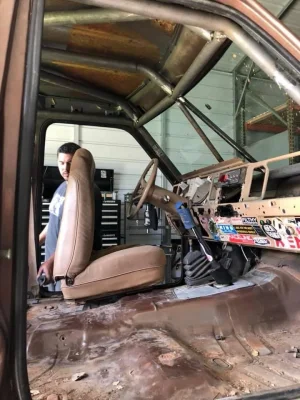

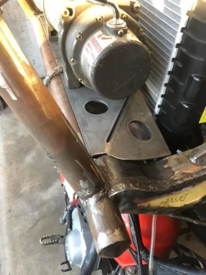

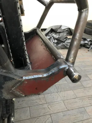

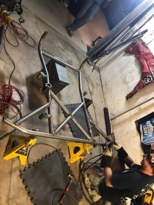

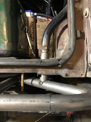

Chassis/cage: frame backhalfed behind the doors, front of frame has been chopped and has full engine cage/bumper/winch plate/skid. Dove nosed. What’s left of the Frame has been plated on the outside and boxed on the inside. Sliders from fender to fender. Full internal 8 point cage. All Tubework is tied together. Lower link mounts bridged, flatbelly skid.
Other doodads: warn m8000 winch, hand throttle, 14gal rci fuel cell, optima yellow top, hand built my own wiring harness for dash and all accessories (built into factory dash trim), still has full carpet and factory seats(for now) with PRP 4 point harnesses at all 4 seats. Both doors still open and close with ease hahaha
