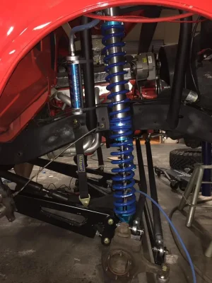

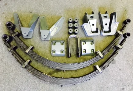

Nate@Blitzkreig had this front kit and he has used my 64" spring kit in the rear in the back and the truck works very well!

Blitzkreig Front and Giant 64 Kit rear is the best setup for your truck. Buy once and cry once with these prerunner deals. So get a good job with you college degree and save up and collect the good parts as you can afford it.

the only issue ive found with the kits, at least for the front end is that the hoops for the coils wont be right with the exhaust manifold and turbo, at least to brace it effectively on the passenger side
