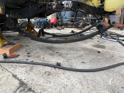

First things first pulled a spring from the ruf pack that was on the runner they work good but I’m trying to keep this thing as low as I can and cut a lot of the fenders and body off it I need to. I was going to French the hangers but I’m lazy and have a lot to get done in a short amount of time.
The anti wrap leaf on top is great idea broke a lot of spring packs before I found that out. 🍻

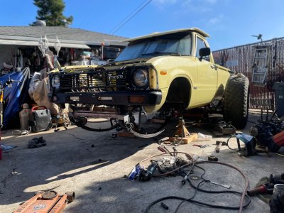

Got the motor and trans out and most of the front end stuff off time to start cleaning the frame and Sas it. Anyone ever run stock rears in the back reversed? I was gonna put 63’s but I kinda don’t like how far back the shackle hangers are I’m gonna build a bed and want this thing to not be a boat.

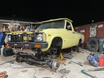

Got all the ifs junk cut off and the rear axle pulled all the dash and wiring ripped out going to mount the front and rear axles tomorrow I had to notch a lot of the body mounts out to get the front hanger where I wanted it and the right distance to mount the shackles. But I’m gonna do boat sides and weld the cab to them anyways so not a big deal.

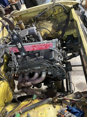

Engine in and front axle is mocked up need to get the trans in too and set it on its own weight before I burn it all in make sure the shackle angle is good. 🍻 I’ll post more updates tomorrow after I cut the trans tunnel and get the trans mounted.
