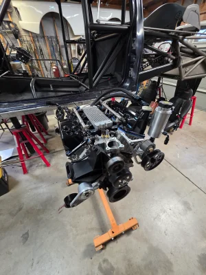

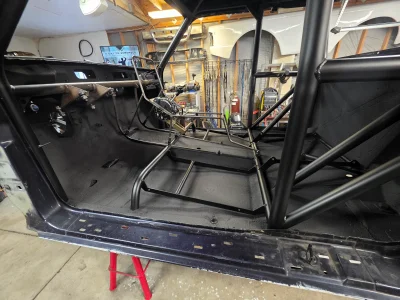

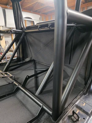

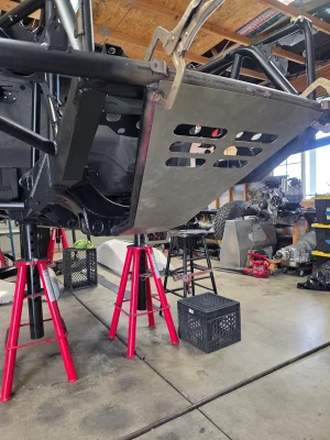

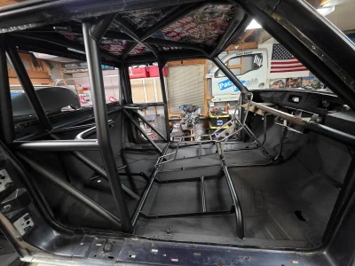

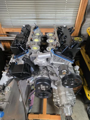

Its been slow going. I did get the floor in the cab sprayed with sound deadening and painted the bottom half of the cab cage. Also the engine is ready to go in and be finalized. im now waiting on getting the trans finished because im upgrading to a extreme automatics reverse manual valve body with engine braking. so once I get that back the engine and trans will go in and I can start finishing everything. Also got the skid plate mock-up done so now its time for the aluminum one.
