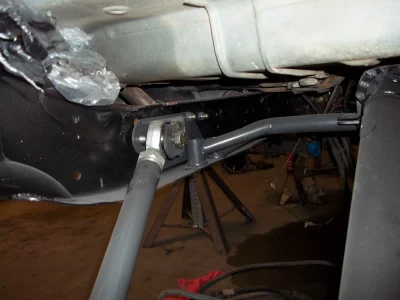

Mine are 1.75”x.120 DOM, around 40” long but I don’t recommend that 😂

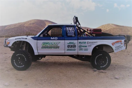

2”x.250 is what we use on a ranger 1400 truck. Taco’d 1.75x.120 on the first real test but they’re around 60” long and a barrow spread because ranger. Bent a 2x250 wall as well in a rollover. Can’t believe the Heims and bolts held
