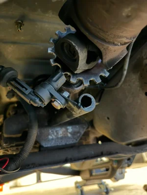

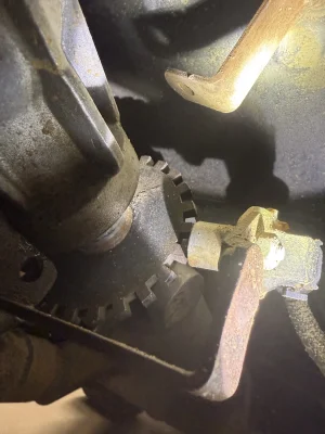

when you get a chance could you give me a count and possibly a diameter? after driving it around for several miles, it does throw a code but does not change drivability any.
sorry i have been busy with life and 2 little kids. i will have some free time today before i take my daughter to get her shots ill get some pictures and a tooth count
