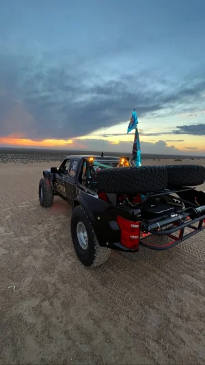

Hey guys,
Wanted to get some opinions on this.
my truck is pretty heavy and i have been thinking about doing some revisions to put the truck on a diet per say. As we all know its a game between power and weight. Currently i have a mildly built 6.0 LS motor, btr stage 4 cam, injectors, 102 mm tb etc. It made 321 to the tires through a th400 and 9".
I currently carry a spare driveshaft, 2 40" spare tires, floor jack, 2 fluid containers, cooler etc with a swing up trunk on an actuator. I have a mid mounted 32 gallon cell and trans cooler.
Most of my trips/runs i stay fairly close to camp (within 15 miles) usually going to glamis etc. I am considering cutting off the rear back half and making a simpler structure with one spare tire and moving the cell to the back of the truck. This would leave me with a storage box by the cab where i can load gear (jack and spares etc) if needed going on a big run.
I feel like i could easily shed 500lbs off the truck and wanted some insight.
Other option would be leave it and keep it well loaded and add more power, Im not opposed to building my motor more but i do like the simplicity and reliability of my setup at this time.

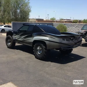

I will not copy marcels truck but this is similar to the style i was thinking.
Another idea i had was leave the cell mid mounted and install the spare tire below the bedline in the backhalf of the truck. Then paneling in the top of the bed and create a functioning tailgate assembly to access storage. Similar to a sand truck style.

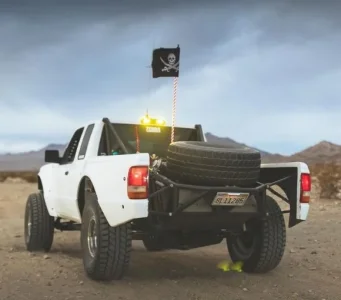

7900 lbs full of diesel and tools. Front 4600lbs, 3300lbs rear. 42 gal cell in the very front of the bed, 40" spare, jack, etc. Not sure what it does power wise, but ide bet somewhere around 350/600 tire. It's not winning any hole shots, but it will sit at 80mph all day and still gets 10mpg+ in the dirt.
you can thank me by showing numbers! hahah. Make sure it is full of fuel, etc. (#'s above were full weight, with my fat ass subtracted)
