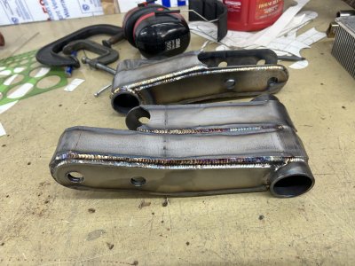

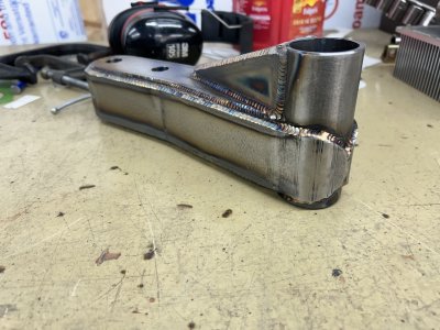

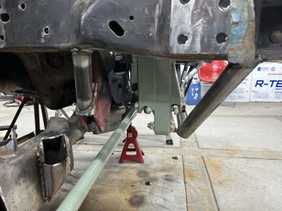

I think the main reason I’m able to run straight tie rods is that I have the drop brackets over the cut and turn beams.
Actually I’m not sure now…
My buddy did a dual swinger on his bronco with cut and turn beams and was able to run straight tie rods. And I loosely copied his design for my swingers. Because I have the drop brackets my geometry was different from his.
For example
I’m not sure I needed to make my swingers as long as I did. but it cycles clean.
I really didn’t know what I was doing other than I needed to pick up the lower pivots to not get bump steer. lots and lots and lots of trial and error in this set up. More than I care to admit 😂
I think the bent tie rods are more common with a single swing type of set up?

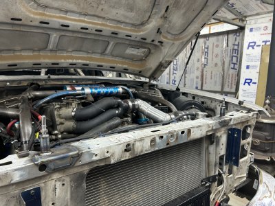

I’ve been working on the front end list.
Nothing too exciting,
-made some hood pin mounts. I’m not too happy with how they came out but they should keep the hood closed.
-secured some more wiring
- installed the headlights and grill for the 427th time. The fitment for the headlight bezels to fender and hood inst that great. It’ll work for what I’m doin though 👍

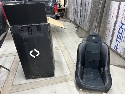

I actually rage ordered these things like 4 months ago 😂 I didn’t think I could fit two car seats in the back of the jeep. Turns out I can lol.
I’ll throw these in the back of bronco once I start on the interior

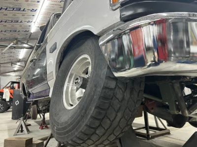

While I had the coil overs removed I figured I better check full bump now that I have fenders and fender wells….
Yikes….. and I still have some up travel before the bump stops bump out.
—I was a little ambitious on how much up travel I could squeeze out of this thing. I never cycled the front end with fenders untill now.
untill I want to rethink my inner fender wells I was thinking about shimming out my bump stops in the can a bit…. that way my fenders and fender wells don’t delete if things get spicy.
Shimming the bump stop in the can seems a little scetchy, but I think I’ll give it a try.

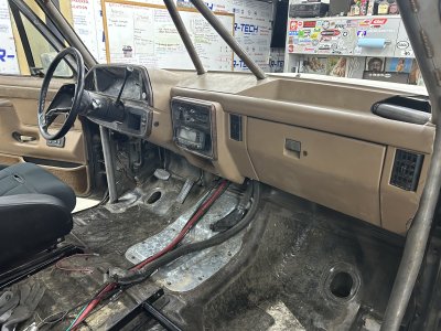

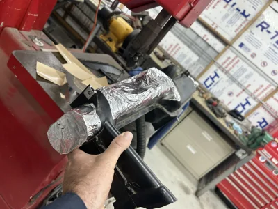

Got the dash installed, I was even able to cut up and duct tape a portion of the original HVAC plenum to give partial air to the driver and passenger and some lines that I will plumb back to the rear passengers through the center consul.

Thanks dude 👌 I will keep you guys updated if it moves enough air to keep everyone comfortable. I forgot to take a picture of it when I had the dash out. I was stoked to get it back together and I forgot to document.

God damn I'm impressed with how well you fit the dash on the A tubes. Also being able to salvage factory ducking. I ended up completely having to guy my ducting to get the dash to fit. Pretty bummed to have lost AC because of that.
It looks better from this angle on the A tubes, but the back side where they slide into I’m not too proud of 😂 I’ll cover that shit up with a nice little dash mat some day.
And I butchered the sides of the dash pretty good when I was still trying to install the cage without pulling the dash. but I will do some sheet metal stuff to secure the dash and clean it up.
The picture I have of the ducting cut and tape up tottaly sucks. But I’ll show what I did

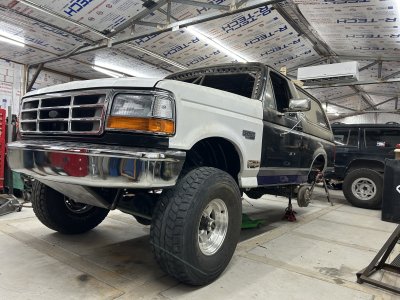

Was able to take the bronco up and down the street to test steering and breaks,
Both worked very well 👍
the quick steering will take some getting used too.
I had to go back to the 500/550 spring combo, I think the 250 top spring was way too soft. Once I actually started moving the front end dove so hard I thought the coil over mount had tore off 😂 even the 500/550 combo has more sag than expected.
After the rip around the block I parked it
Added a little pre load to the front coils
Installed the bump stop extendo pads
Added corner supports to the front bumper

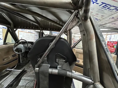

Then started on seat belt mounts and harness bars

I had been debating on just keeping the rear bench for now….. but when I went to throw the bench In to test fit, I noticed a mouse had been living in the internals of that bench…..

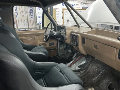

-now that that bench smells like mouse piss, I will go ahead and reconfigure the rear to fit two full sized seats.

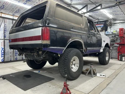

What length Bypass and diameter body do you run in the back? Are they mounted outside the frame rails on the stock width rear end? I'm thinking about switch to this set up for a better shock angle then my current under body shock mounts.
I’m running a 2.5 3tube bypass 16” stroke,
It’s on the outside of the frame rails with the lower shock mounts on the spring plates.
Though I think a 3” shock will be in the future now that the front suspension is not a limiting factor.
- It handles very well, I can even take a little valving out of the shocks so I can fine tune the top half of the bypass.
- the cons,
The bypasses are extremely loud, to the point that head sets are needed.
Fitting two full size seats will be a squeeze, but they should fit.
- the cons,
Do you have a stock rear end width aswell? Wheel spacers?
Definitely worried about noise my tundra was ungodly loud without headsets aswell from bypass chatter.
