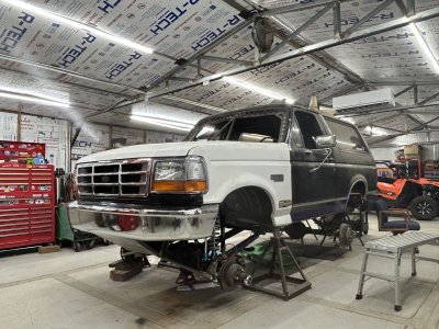

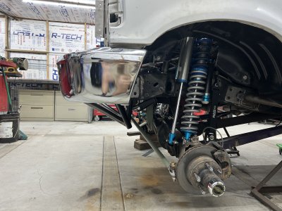

love it! any pics of it with all the front shit together. the headlights, and that little trim piece above the stock bumper????????
I had full intentions on getting the bumper and trim pieces on last night, but after having to trash a few pieces of tube that I feel like I spent an hour on fitting up i was over it 🤣

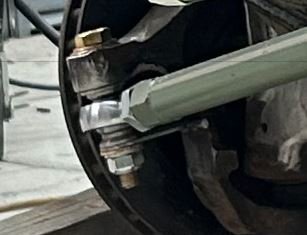

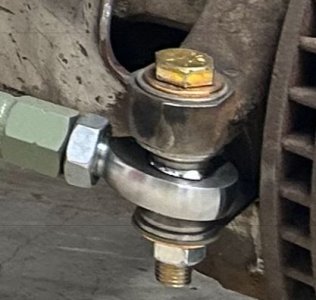

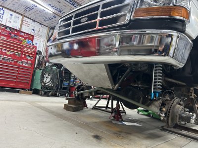

Looks good did you double sheer the spindle if so can you post a pic
Yeah real basic double sheer with 1/8 chromo, I also made a weld washer that will catch the top of the hole as well.

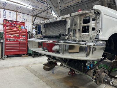

- removed the bumper, cut out some material to make room for the skid plate.
-On to the skid plate.
tacked the tabs and took some measurements. Easy peasy…..

-cut out the skid plate
View attachment A54D146B-DCC4-4741-9E7A-9FD7C50BCF8E.mov
-Dicked around trying to fit the skid plate for way too long.
My stupid ass bend on the lower tube really screwed me up. THIS SHOULD HAVE BEEN AN EASY PART! 😂
Anyways, trashed that skid plate. Then I CAD drew up skid… which I should have done in the first place.
View attachment 90D9ED1E-D4F1-4BE8-81A4-364860F5D07D.mov
Now I have a template for the next attempt on the skid plate install.

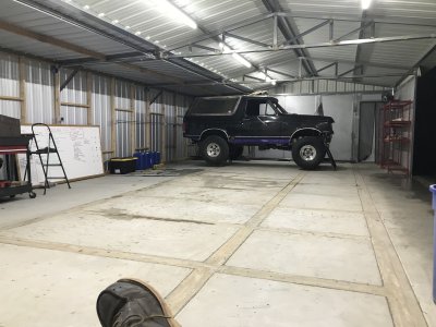

Kicking ass is kicking ass, even when it’s yours lol. Is that a home shop? Nice setup!
good way too put it. 🤘🏻

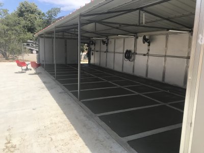

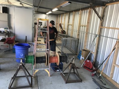

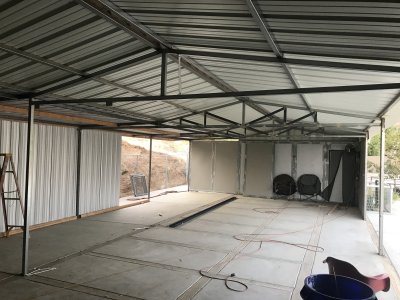

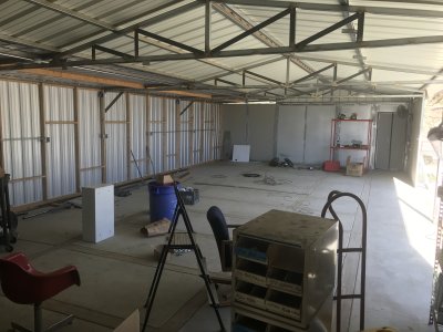

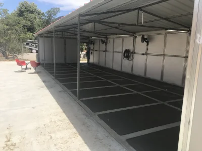

We bought this house back in 21ish, the guy that had the house before had this bad ass dog kennel set up, he trained service dogs- policy, bomb, drug, ect…
So after we bought it I converted it into a shop
The square looking things on the floor were the kennels, after gutting the interior I had some concrete pour to fill them in.
Then inclosed the structure.
used that 2” insulation board you get at homedepot.
Part of the reason the bronco was on hold for so long is was cause I had to get this shop together…
ohh and kids….
Mostly kids 😂
Thanks dude!, I lucked out soooo much with being able to get a house with a “shop”
although I think if the previous owner had saw what I did to his dog kennel he would have shot me on site 😅
Here’s some pictures I dug up of the concrete pour.
View attachment 58D3843A-E393-46F0-A100-CBEB2BC9B0CC.mov
The concrete is relatively shallow so I’ve got some cracks already.
