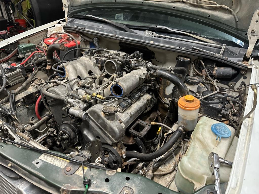

And where i am now.
other head put on, cams in, timing chains in, new water pump, cleaned the front cover and installed, new spark plugs (resistored racing ones again lol) and gapped to .032 and finally, water neck/tube installed.
top end is pretty much done till i pull the old motor. im putting all the OG stuff from my tracker on the top end since its fresh and far less build up inside (cleaned it all many years ago). i do need to flip the engine and put in the support for the oil pickup. i missed that when i buttoned up the bottom end. easy fix though. Then a new front main seal, balancer and put the valve covers that came on this rig on top to just keep the engine sealed till i get the blown one pulled. See how this week goes, might be able to start disassembly of the tracker to pull the engine. Wont have any time this weekend to work on it, i dont think.
i was debating back and forth on putting the re-ground cams in this engine and im still debating it. they didnt really give me much boost in power before when i was n/a (dumb fucks at crower cams didnt listen to a word i said or asked of them) and i doubt ill notice much on the boosted engine.

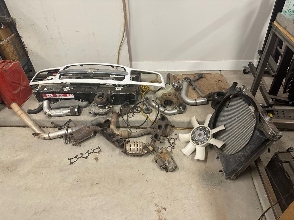

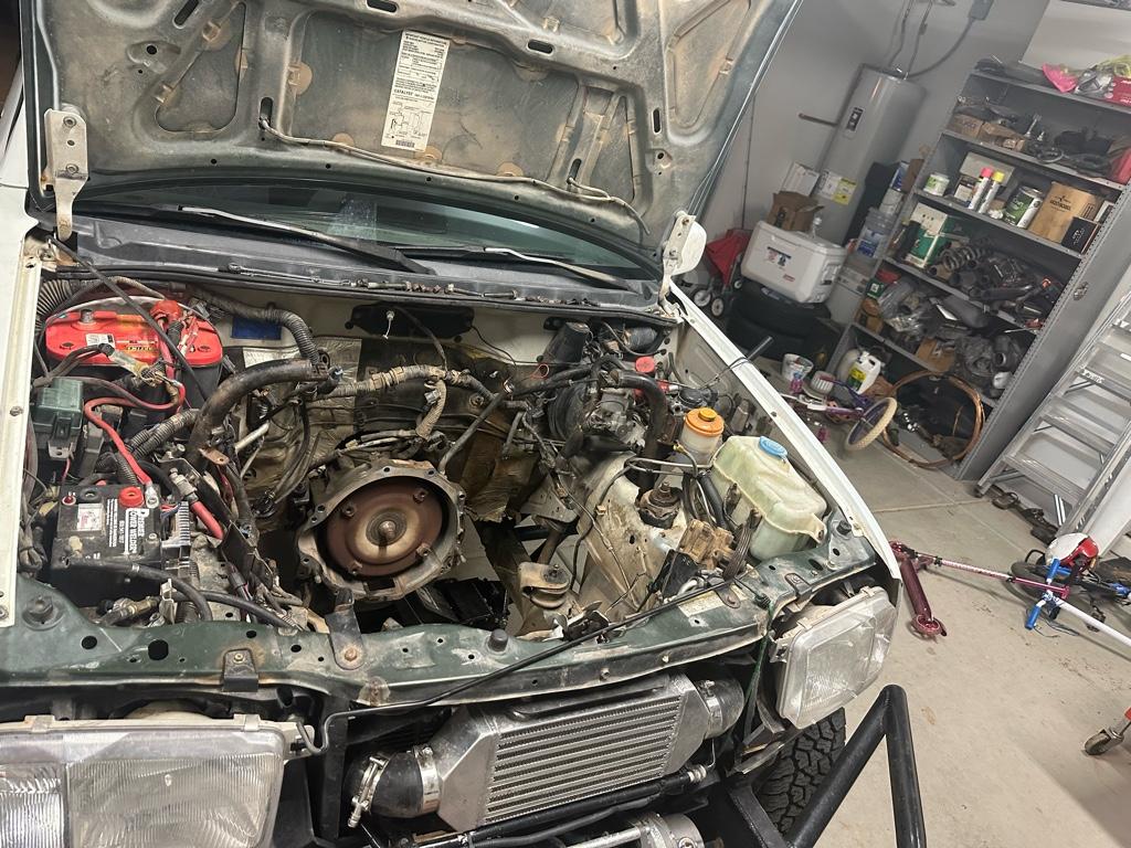

Plan tonight is to bring the tracker in and start pulling the old engine out. lets see how far i get.
