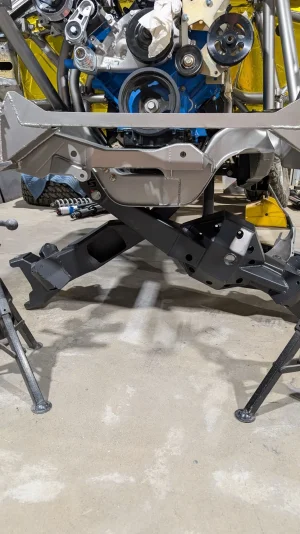

Your build keeps looking awesome, and I really appreciate you sharing all the details. I've been using your setup as a research reference . I had a couple of questions I was hoping you could help with.
First, do you feel like the way you set up your TTB/frame gives you more uptravel compared to a standard +2 2WD beam setup? The DIY off road one specifically.
The reason I’m asking is that we’re hoping to run 37s with the same Autofab fenders you’re using. With the oem style innner fender mounts, We’ve seen that you’re able to make it work, but since you’re running TTB, we’re not sure how the uptravel situation would be for us. If your setup does give you extra uptravel, then we will know we can make it fit.

@SVTSC - definitely doesn't give more up-travel compared to 2wd. The pumpkin runs into the frame rail as my limit of up-travel. a 2wd beam setup wouldn't have that. That said, I have 8" because I notched the frame a little bit and I also raised up the bronco frame rail section compared to the f100 frame when I did the splice.
That helps me visualize it a bit in my head. Im hoping we can fit 37s like you did.

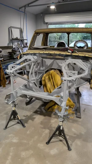

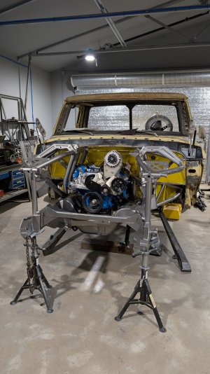

got the engine back in. It takes a very careful dance & some precision tilting to dodge all the brackets & things but I was able to do it in an ~hour with a buddy to help spot.
also: gold.
I reinstalled the intake manifold and got the injector installed as well. Gonna have to get some different fittings to clear things (not pictured today)
but for now the priority is to finish painting things and reassemble the front end to reclaim the garage. Shit is yardsaled everywhere right now and drives me nuts.PXL_20251122_032955246_resized.webp

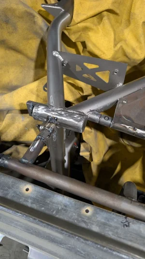

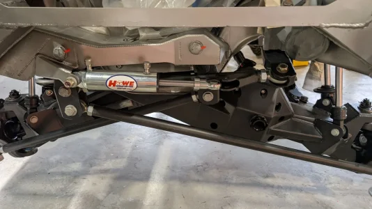

Mocked up the ram assist cylinder for the first time & found out the tabs on my drag link were incorrectly located.
The good news is that this whole steering system was developed by Andrew Cho and he operates with integrity. He's been super easy to reach for help and has been very helpful with figuring out solutions. He provided me a replacement drag link (that also isn't quite right for my setup, doesn't bottom out when I want it to). But all in all I can't ask for more out of OhhCho and I'm super excited to see all this stuff in action eventually.PXL_20251213_234129262.webp

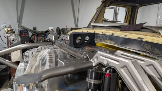

Also started trying to figure out things like the reservoir mounts. I got myself a new 3d printer so I came up with this idea that I want to try.
Here's the first mock-ups out of PETG to finger out the hose routing & adapters we'll need. The final product will be made out of PPA-CF so it doesn't melt under reservoir temps

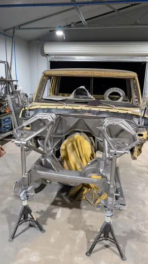

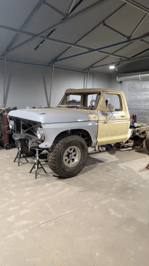

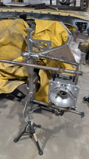

Also learned that under full-welding of the engine cage that my stuff warped just enough for the 2-bolt flanges for the fender mounts to be too difficult to reinstall. I never really liked how they looked anyways so cut them apart & replaced with some interlocking tube clamps. Then put the hood back up & remounted the hood pins and the front is SOOO close to 100% complete on core structure.
