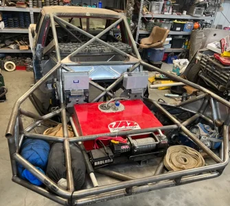

That’s a very valid point. I have quite a bit of storage with my rear cell. 2 small action packers against the cab with spare fluids and spare alternator, ps pump, fuel pump, wheel bearings, coil, plugs, etc.
then a tray for 2 big action packers directly over the axle. One gets packed with clothes, jackets etc and the other gets a soft cooler for food/drinks.

Rear mounted cell will always be my vote. With the correct shock package, weight, and setup you can do amazing things to the ride quality of a truck! We went with a 70 gallon cell on our truck, from 3/4 full to empty the truck feels drives very similar, however the more fuel I carry the "smoother" the truck feels in the rear.

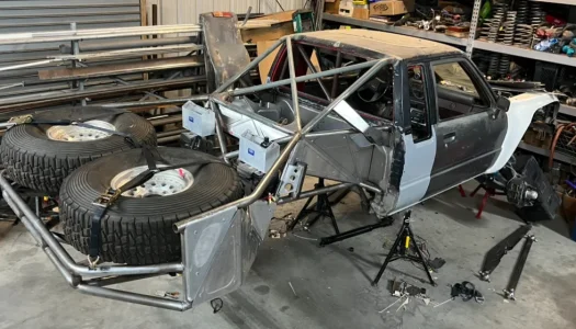

Ive always bounced the idea around to mount the fuel cell in the rear, and the spare tire (just 1 for my setup) as far forward as I could get it, even if that means finagling it between the down tubes coming off the cab. Then run some kind of storage/trunk for tools and as much gear as I could fit, with an upper area to strap a cooler (that shits going to get "SHOOK"!) and whatnot to. Not a conventional setup by any means, but I wouldnt be building a race truck either. I mean, how often are we accessing our spare tires? In all my years of doing this stuff, Ive only ever changed my tire 3 times - other than that, its always in the damn way to access other stuff (which is 99% of the time).

I have had mid mount cell with lots of storage and rear mount fuel cell. I believe both have their place. For optimum performance a rear mount cell is a must. I will probably never build a truck with a mid mount cell. On my current f150 I have a 70 gallon rear cell with plenty of room for a storage box that can hold a decent amount of stuff. I haven't had time to build the storage but soon. Fuel cell placement depends on the build.
