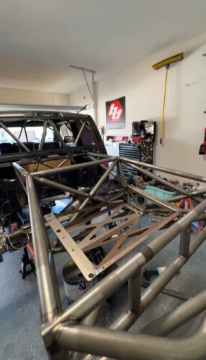

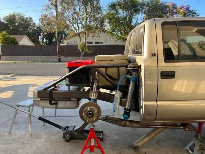

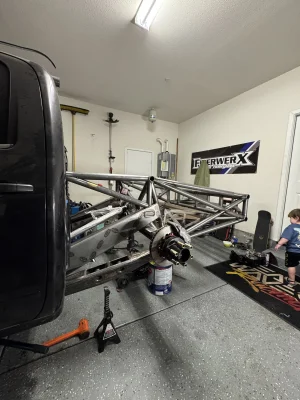

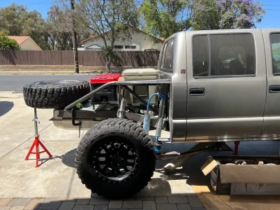

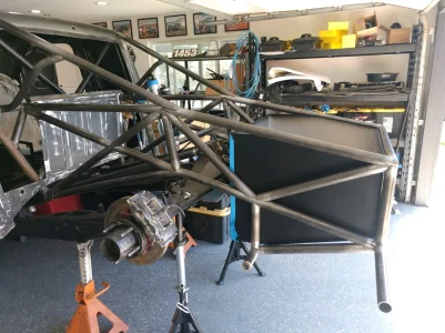

So this seems to be a highly debated topic and I’m curious what most people lean towards…
so how do most people feel about mid fuel cells vs rear fuel cells?
Rear mounted obviously helps with weight bias (when full) and I also see it being a safer option keeping the fuel further way from the occupants..
Cons of rear mounted is the rear weight bias can fluctuate drastically over the course of the day making the tuning of the truck unpredictable as you have less fuel. And also far less easily accessible storage by not having much of a “trunk” space
Mid mounted doesn’t have this effect in the same way because it has far less leverage to act on causing a 2% change in tuning vs an 8% change in tuning.
Also the weight bias is able to me made up but doing stainless steel rear skid plates or paneling in the rear, tools, fluids, spare driveline, jacks, can all easily be mounted in a rear “trunk” making a lot of weight up without it being fluctuating weight.
What are our general thoughts on this? Keeping in mind this isn’t a race truck, more a track hopper, Mojave trail runner etc etc. also keeping in mind this is a Jaz jeep speed 32 gallon not some 75 gallons+ cell
