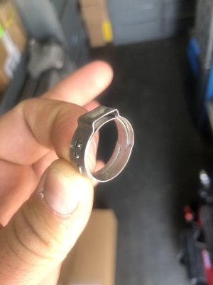

I used stepless clamps on most my push lock hose fittings; fuel, steering, vent lines, etc. They’re fairly cheap insurance.
where did you find a good place that sold them and the tool for a decent price? there are so many different bands with prices all over the place.
These are what I use. Oetiker brand.

Find out what sizes you need (in MM) and I can possibly send you a goodie bag. Largest I have in stock are 21mm. Pretty certain they’re all stainless.
Hell I’ve even had good luck with the larger ones I’ve picked up from Lowe’s.
thanks @GahnRacing but after checking theses out i would have to remake (buy more hose) to install these. i will put it on my "to do" list. for now i will just us some worm type hose clamp with heat shrink on it.
besides, i know you will need your supply on your next build.
+1 Oetiker is what you would use. However if it is just a low pressure return line then you really don't need it. There are other forces at play if you overpressure a return line. If this is something that may happen (really shouldn't but...) then I would just use high pressure lines and fittings on the entire system. You can also get smooth bore or smooth I.D. worm gear clamps from NAPA.
