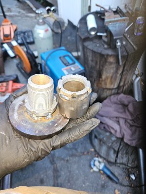

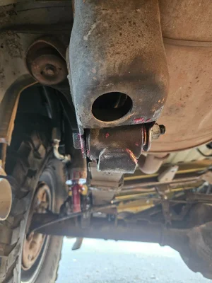

I'm confused on why not burn out the old bushings and use some standard bushings? What's the purpose of the bronze bushing?

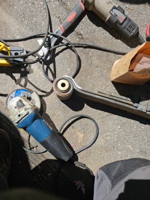

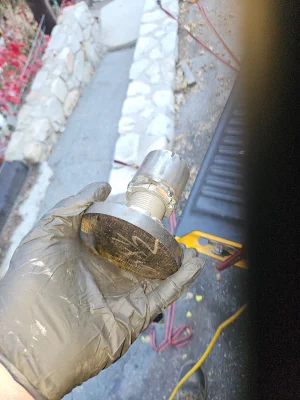

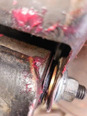

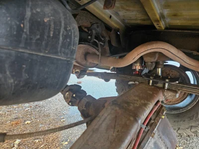

I might get around to it eventually. The plan is a bronze washer-bushing sandwiched between the crush sleeve and the mount on both sides — basically filling the gap left after grinding down the serrated ends.I'm confused on why not burn out the old bushings and use some standard bushings? What's the purpose of the bronze bushing?

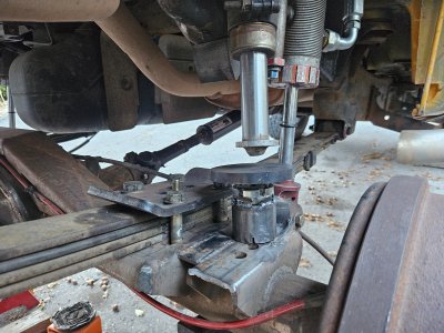

The truth is, this whole thing is just the cheapest, laziest way I could come up with. I’m deliberately putting in as little effort as possible just to see what I can squeeze out of it. Yeah, there’s a tried-and-true formula for making leaf springs work — I just refuse to use it.
I don’t know why, but it entertains me to tinker, manipulate, and see what I can get away with. Definitely not something I’d recommend.
Woah, easy there fella.They're basically 5 spoke Robbys lol
