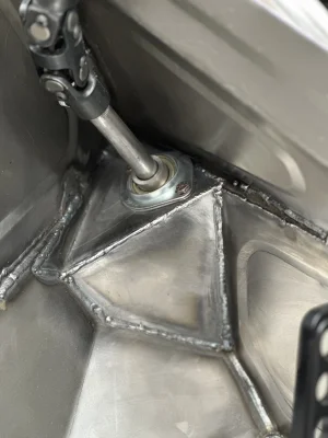

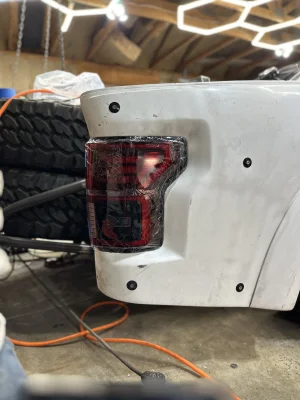

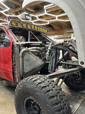

Made quite a bit more progress on the drivers side panels. Finalized steering and got the firewall uniball setup. Getting closer to finalized interior and after that I can move on to mounting rear fenders/tail lights, couple misc things then it’s tear down and Powdercoat time! IMG_0832.webpIMG_0835.webp

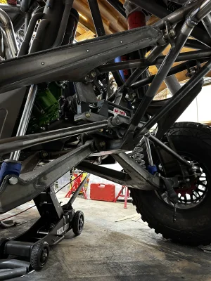

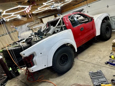

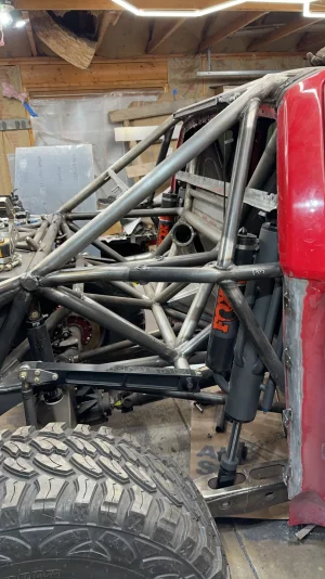

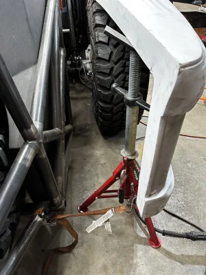

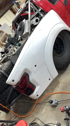

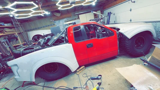

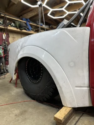

pulled the front shocks after to set it on the ground and get the rear fenders done. IMG_0897.webp

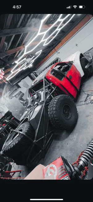

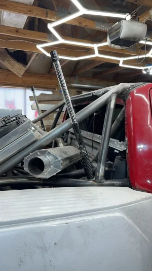

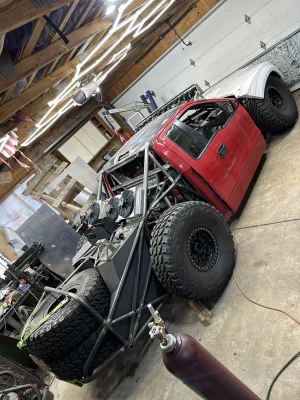

This thing full bump is pretty crazy looking. I’m 5’9 for reference. IMG_0919.webpIMG_0903.webpIMG_0927.webp

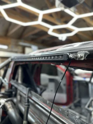

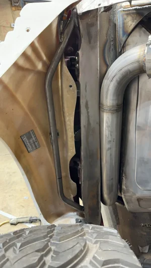

Started mounting rear glass and made some brackets for some hidden hardware. IMG_0929.webpIMG_0931.webp
Yea, nice tuck. Finkle is Einhorn!
What is lowest point and measurement?
bedside glass doesnt seem to match that cab perfectly at the body line where the cab flares out at bottom??
Feels good to see it like that too, huh!!?
So its going to be Midwest Dirtfest 25 ready?
It’ll be ready but not sure I’ll run it at that track.
Lowest point is 4” from the ground. Lowest height at the roof is 57” when bumped.
Glass fits really well actually everything lines up perfectly just a shadow messing with that cab line. Thanks man I’m super pumped to have to this point!
I think that's the shadow from the cab your seeing. Glass looks to fit pretty well!
Correct! Fits awesome!!

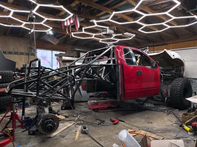

Making some pretty big steps! Starting teardown to make room to make brackets and add front brakes. And a few other misc things then it’s game time for cosmetics.

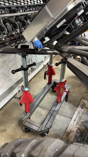

Also got rid of the death trap vevor stands and made a new truck dolly.

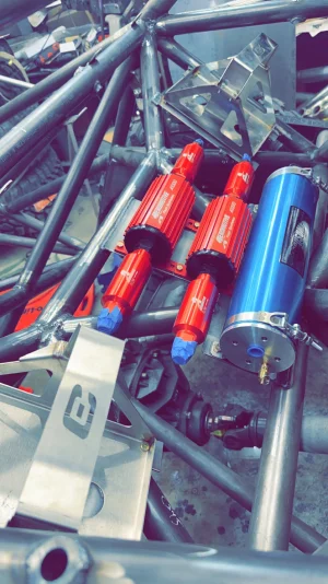

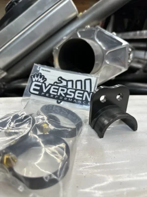

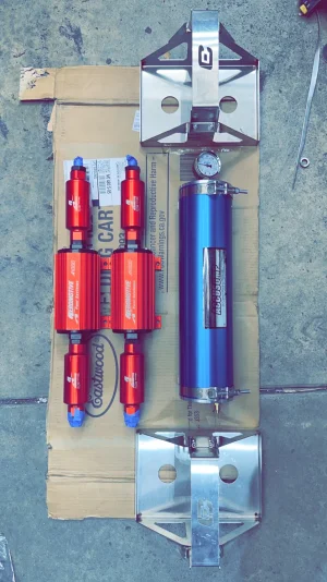

These Eversen performance bulkheads are pretty trick also.

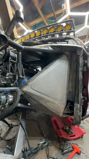

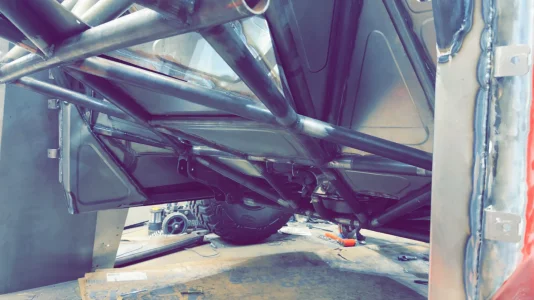

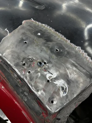

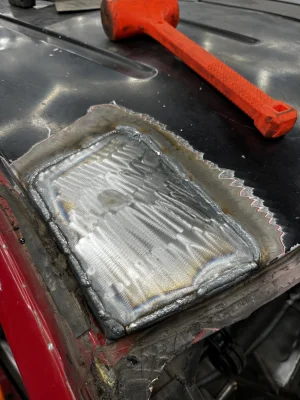

Whoever had this truck before me loved drilling holes everywhere. Patched that up on both sides until I can find a nice donor roof. (Harder to come by than I thought with a regular cab.)

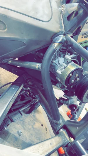

Had to redo some tubes to fit the ac compressor with a new bracket.

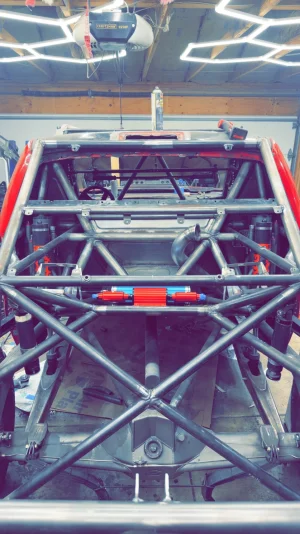

Fucker is close to going to powder. Hopefully end of the week. Also lowballed a dealership on a trailer so hopefully that works out also 😂🤘🏼

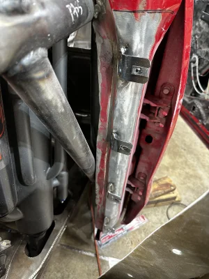

Did a shit ton of dzus tabs
Remade some tuning for the AC compressor

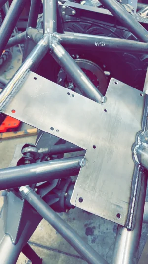

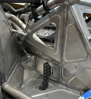

Mounted the brake pedal and tabs for the front brakes. (The brake pedal mount got more reinforced after the pic also seen is temporary hardware holding it)

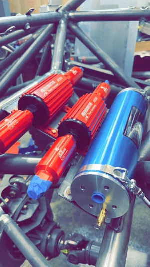

The Prerunner Farm makes some badass weld on hose clamps.
She’s finally ready to become one color
I was just gonna say that brake pedal probably gonna flex the mount ... but you said you reinforced it more. I was surprised how much I was flexing shit with even my hand brake. Made me feel buff watching a 3/16 tab flexing. lol
Wonder if prerunner farm make those with different sizes? like a 10/8. If they don't they should.
