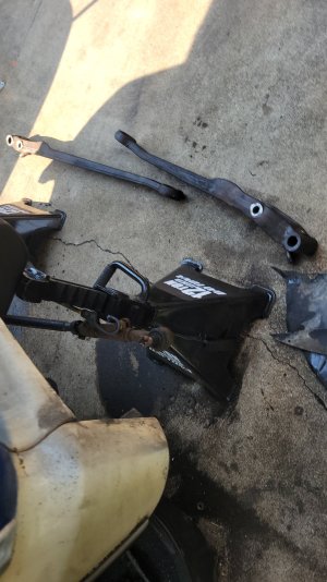

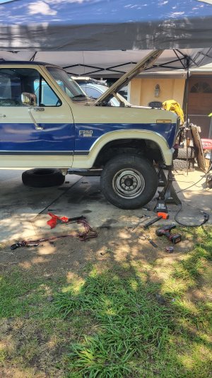

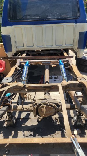

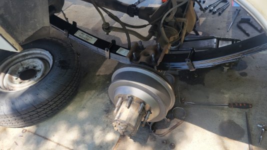

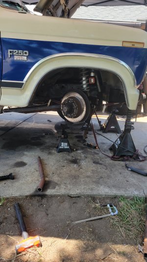

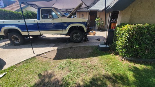

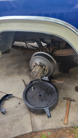

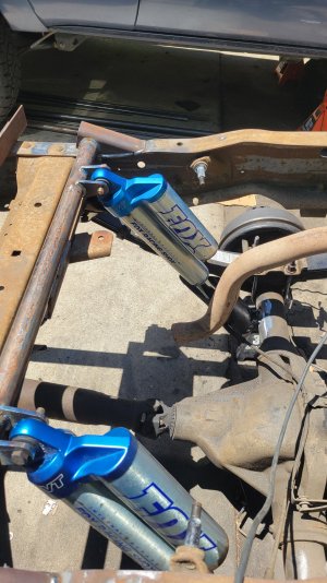

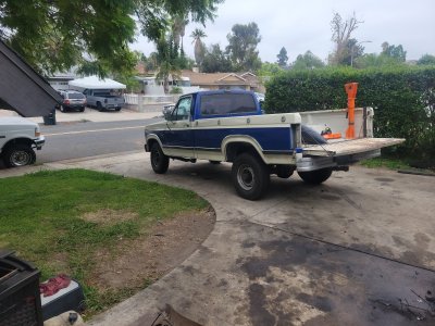

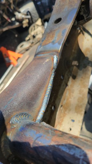

Im posting this thread for a buddy even though it now appears I just work on diesel garbage now 🙃 😂 he bought the truck a 1986 f250 xl 420ci 6 9 IDI diesel about a year ago now but he got it for 500 dollars from a neighbor but after figuring out he can make it decent with the beams and him having a blast driving it we figured out a suspension package based on the rear shackles and spring from solo, fox raptor gen 1 rears and king 2.5 x12 coilovers withe desolate radius arms. We just got done with the rear suspension and a 38 gal fuek tank swap and new brakes.

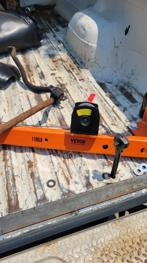

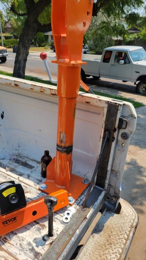

Oh forgot to mention he's fully on board with it being a farm truck so it now has a 1100lb vevor crane that I cut down and put a backing plate on the bottom of the bed. And finally just got the bed back on and now we start on the front

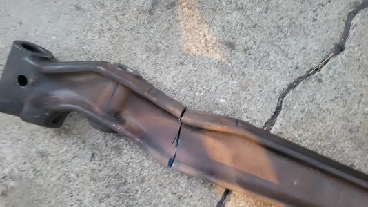

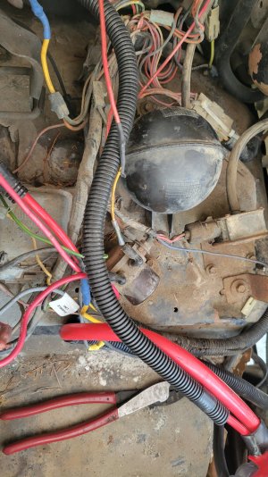

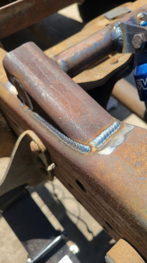

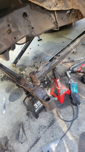

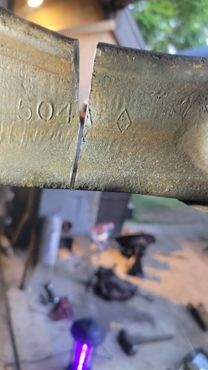

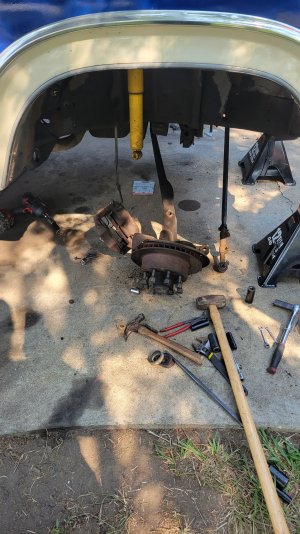

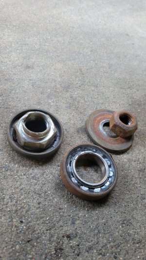

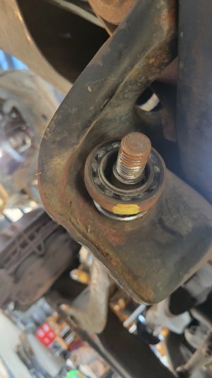

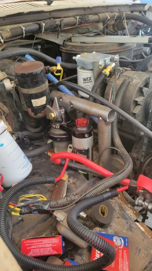

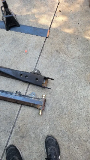

Also did end up starting on the front by just tearing everything down and just a basic clean up still waiting on the pivot bushings to show up tomorrow but in the meantime Time im going to start doing the fuel pump and e fuel conversion along with the coolant filter and cleaning up this rats nest. Oh and farm truck bushings from god knows when was doing great but a swap for fk rod ends is a must hahaha. (Contains random Honda cv axle nut,a koto bearing and some tie rod ends boot from the looks of it)
