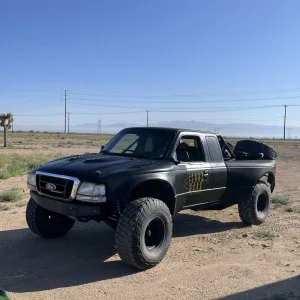

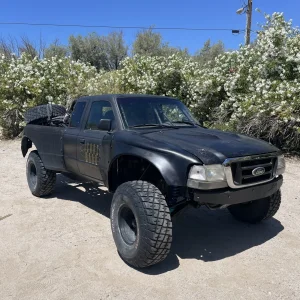

Hey everyone, new to the site.
I’m gonna be posting a build thread on my 2000 ranger.
I originally built custom upper and lower arms that cycled 16” and 1.5” cage front to rear. Since then it’s been recaged and rebuilt 3x by myself never rolled just upgraded.
Now it’s all 2.0 Dom still has the 3.0l but now it’s turbo charged. Solo cage, with a TE back half Camburg rear end, camburg links, Btf front race kit. Up front 2.5 and 3.0 12” kings with 2.5 bumps and rear has 3.0 and a 3.5 16” 18” with 2.5” Bumps and Howe power steering system.
anyway the entire list will be on the thread.
Thanks for having me
