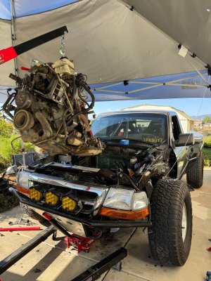

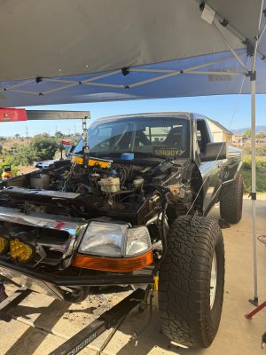

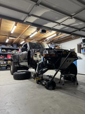

Don’t weld em in until you fit the motor, I had to leave mine super loose to get everything to line up and it was a nightmare

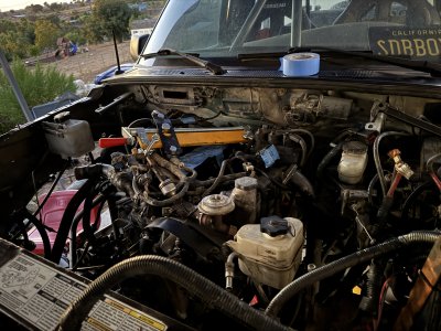

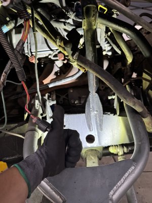

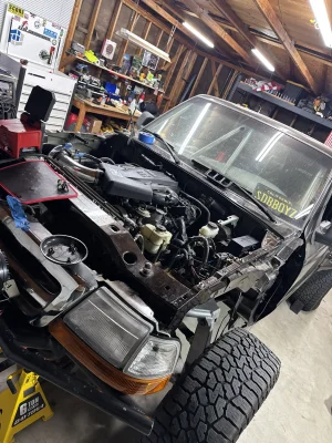

Got the motor 90% of the way mounted. Going to drill an access hole at the bottom of frame rails so i can fasten the motor mounts to frame instead of welding them on. Thinking of doing a "washer" plate around the openings so i can leave the opening in place
