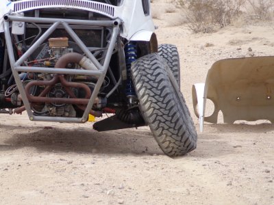

Nut could have backed out but if it did it was very little. Taking it off with my impact it still struggled. Speedway says with the solid spacer they install in it that it’s only 160flbs

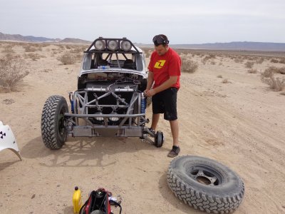

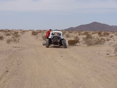

The pivot bolt on the rear arm backed out on the trail, just my dad and I in the car. No other vehicles no radio no cell service.
we had to walk the trail till we found the bolt.
I didn’t have a jack so we removed the front tire and coil over, dug a hole to drop the front end in which would raise the rear end, pull the rear coil over and ratchet strap the arm back into place…. And of course I don’t have the big ass Allen wrench to tighten that pivot bolt. I probably got it close with a rock and channel locks 🤣
Then reverse order to get home
I carried a lot more tools and took prep a bit more serious after this trip.

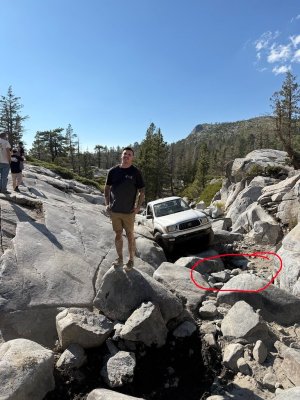

Yea this section gets prettty spicy.. this was like hour 7 of our push to Buck.. half the group took the bypass half of us went into the lions den haha
@the_fablab_ on 40s got all twisted up and had to pull winch line.. 3 other trucks opted for the bail out off to the right and then out boy Hayden sends it and wastes the passenger side and blew up a CV haha. Good Times well the wives didnt think so haha

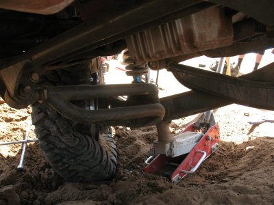

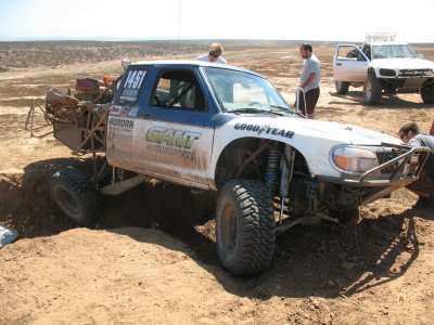

Here is an old one from 2008. Hit a square ditch that folded the radius arm and all the cross over steering! We fixed the radius arms and put stock steering on and found out that the stock steering was way better and we left it like that for the rest of the truck's life!
What made the stock steering better?
